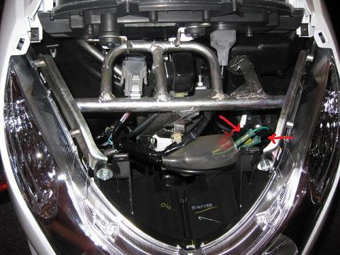

I did the brakelight switch today but I'm at a standstill now. All the panels I mentioned earlier were removed in 20 mins (that was the fast part) then things got tricky snaking and routing the switch wire down to its connection behind the meter panel. It's in the right location now but I can't get the old switch wires disconnected. Me and wires? Not so good as of late
Now asking for help on disconnecting them

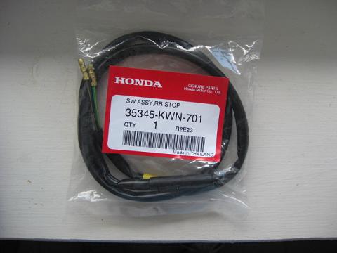

- 1. New Left Lever Brake Light Switch Assembly.JPG (27.12 KiB) Viewed 3759 times
- 2. Brakelight switch connection at a distance. Housing boot was pulled away to get access.JPG (51.45 KiB) Viewed 3759 times

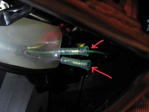

- 3. Brakelight switch connection up close. How do I remove these 2 wires from connector.JPG (37.3 KiB) Viewed 3759 times

Looks like that transparent green silicone is just insulation to pull aside. Then unplug the bullet connector underneath. Use 2 pliers either side for grip if they are tight. If you break the insulation just re wrap in electrical or other tape!

Taz thanks for the tip. The silicone insulation is on really tight. Geez, is it heat shrunk on there?
I thought about holding a needle nose pliers at one end while pulling at the other end, but then decided to ask here first. I'm a bit fearful of tearing it and maybe even damaging the connector inside it (along with the "good wires" that run to the other brake lever).
Still, what else can I do? No other choice, right?

its only insulation, cut it off with a sharp knife or scalpel! Its only 12 volts, you wont harm yourself!

Jerk it off with pliers, it'll be fine. Those connectors are the same as the ones for the taillights, and they're quite durable. I certainly wouldn't attack it with a knife though, you should be able to grasp one end, and pull the other out with pliers.

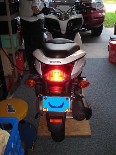

Great Sunday! The deed is done! I used two pliers to pull the bullet wires out of the silicone sleeved connector (thanks Dave and Taz for All your help
Next....and As I expected, getting the "New" switch "bullet ends" into the connector was more of a PITA due to the flexability of the wires. I used a needlenose plier to push them in, but "feeling" the bullets lock-in was hard. To make sure they would stay put, I added some electrical tape.
Turned the key, braked and..... Voila
- New one Works! Left Brake Light Switch & Bulb Replaced.jpg (42.18 KiB) Viewed 3650 times

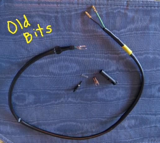

Here is the Bad switch. Yes,
all those fussy bits Are what makes up the left brake light switch.

Part is ordered and the problem will son be resolved.
