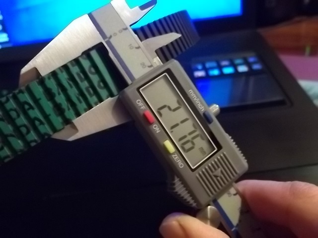

http://www.ebay.com/itm/191823184384?ru ... 26_rdc%3D1
The ebay cogged belt from Thailand I received is consistent but not exactly the caliper measurements you have, close enough but what is the 823mm measurement you have there sir?

How did you measure the width? It differs by 22,1 - 21,76 = 0,34 mm. Could the caliper jaws squeezed the belt too much? I used ice cream paddle in both "V" sides then measure the distance. Also, mine wasn't that new. With new variator the belt in a new bike usually wears at faster rate during several first kilometers, due to the aggressive cross hatch pattern in the variator. In Indonesia, Honda limit 1mm or 24.000km use between belt changes. So, 0,34 mm could mean 3 months normal belt life (in my case).homie wrote:...
