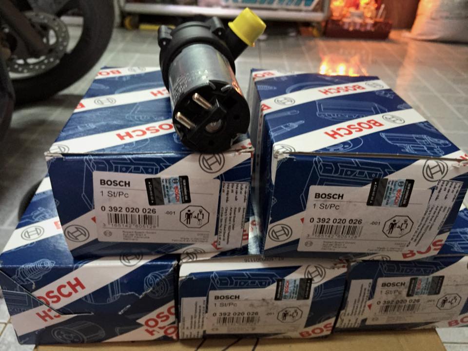

I also heard about switching to an electric coolant pump from Bosch. My friends who race the Sniper MX King 150 from Yamaha do this all the time, the mechanical pump on our Honda engine is pretty much the same, which uses the camshaft to turn the pump if I'm correct. Switching to an electric pump from Bosch would free some HP trying to pull the pump and be safer too, since the electric pump is always on, at least that's the theory, my friends have not run into any trouble doing this. What's your opinion guys?

I like the idea of electric pump, it's been on my mind for a while now...

I'll look into the electric pump idea. I can find a bosch pump pretty easily in VN. For drag racing that's a must. It can put more stress on the battery but I'll get a better battery anyway.

BPT7594 wrote:I also heard about switching to an electric coolant pump from Bosch. My friends who race the Sniper MX King 150 from Yamaha do this all the time, the mechanical pump on our Honda engine is pretty much the same, which uses the camshaft to turn the pump if I'm correct. Switching to an electric pump from Bosch would free some HP trying to pull the pump and be safer too, since the electric pump is always on, at least that's the theory, my friends have not run into any trouble doing this. What's your opinion guys?
I was actually thinking of an electric radiator fan too. That buried fan can easily rob up to 1.5 hp at high rpm and it is not exactly aligned to operation profile either. Sitting in heavy traffic in hot weather with low rpm it might move too small amount of air while at higher speeds where adequate flow is available it might provide too much cooling.
BPT
Can you post a link to a bosch pump used by your friend?

We use this one. The link is a vietnamese shop but you get the idea, there's an image also.
If you know what you're doing it's a great update, but definitely will have to do some CNC mod to get it on there.
http://www.shopp1.com/prodetail-195-226 ... RMANY.html
I figure if you want to be simple just get the yuminashi 1.6 bar cap, much easier. But if you can upgrade to this and the electric pump then you got nothing to really worry about anymore.
Here is a picture of the Bosch pump with some part numbers on it, might be easier for you.
