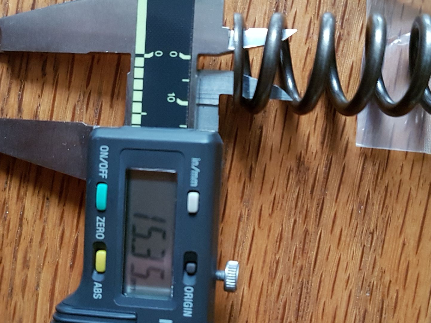

Here are pictures. The package was labeled '15 PCX. Sure hope that is correct! My PD valves arrived today and appear to be correct at 23.8MM.
- Resized_20180716_205126_2457.jpeg (108.42 KiB) Viewed 43209 times
- Resized_20180716_204447_1466.jpeg (192.42 KiB) Viewed 43209 times
- Resized_20180716_203031_4581.jpeg (168.75 KiB) Viewed 43209 times

More... Hard to edit on phone and keep track of each! And do I still open the larger holes to 8MM?
- 20180716_213123.jpg (529.22 KiB) Viewed 43209 times
- 20180716_212929.jpg (603.92 KiB) Viewed 43209 times
- 20180716_212225.jpg (722.79 KiB) Viewed 43209 times

Thanks for the pictures. It seems to get interesting.
The spring on the pictures is significantly stronger than the original, and also has the crossover point at a different location.
The new line is drawn with brighter orange.
A quick rundown comparison with the OEM, all in mm
OEM YSS
initial spring rate 4,55 6,4 +32%
secondary spring rate 6,9 10,8 +56%!
Total length 290 263 -27mm
Crossover w/o preload 85 70
Max. force @100mm 523N 855N +63%
What the above means:
Yss seems to have done the basic math creating this spring. It has ~25-27mm less total length, so installing the PD valve does not put extra preload in the forks.
This spring will require significantly less preload, and initial suspension action should feel similar to the stock spring. 6mm preload of the will produce roughly the same sag numbers as the oem spring @25mm.
On the other hand, it changes to a much stronger spring rate fairly early even with less preload, so about 40% of usable travel will be firmer than stock, then 60% almost fairly strong.
In short, the good news is that your front forks will most probably never bottom out. On the other hand the new spring will make your ride rather sporty than comfortable.
It is also a bit difficult to create good damping for such significantly different spring rates.
As you cannot change valving on the stock damping rods (well, in theory you could close up the existing rebound hole and redrill a smaller one, but without a shop I would not go into that) the only way to change rebound damping is to use thicker oil. with such a high spring force I'd go for the 20w oil, and not more than 1.5 turns preload on the fork valve.
Use slightly less oil in the forks, to have less air spring effect. fork oil is metered by filling and bleeding the forks, collapse the fork completely without the spring, and filling it to a specific level from the top of the stanchion. I have the original values here in the site somewhere, but from memory I recall something around 173mm. I'd use slightly 5-7mm less than that.
As a last sanity check, could you please measure sag figures on your PCX before the modifications? Measuring the sag figure of your bike with your weight and your riding position, we'll be able to calculate the required preload for your new spring - so make it a fully prepared one time effort with the installation.
It helps a lot to have a helper who can hold the bike upright when you do measurements. When I have no helper, I do the measurements beside a wall or door, so I can horizontally support myself whithout changing from normal riding position or putting weight on the ground. I usually use a thin zip tie on one of the fork legs to act as a resettable reference point as it records maximum suspension travel. There's stiction in the forks, and suspension travel is short, so I suggest to use the ractech method of two way measurements.
Step 1: Extend the fork completely (put the bike on the centre stand and ask someone to psh down the back so that the forks are in the ir. pull down on the forks, to overcome the top out springs and stiction of the surfaces) and measure from the wiper (the dust seal atop the slider) to the bottom of the triple clamp. This measurement is L1.
Step 2: Take the bike off the stand, and put the rider on board in riding position. Get and assistant to balance the bike from the rear, then push down on the front end and let it extend very slowly. Where it stops, measure the distance between the wiper and the bottom of the triple clamp again. Do not bounce. This measurement is L2.
Step 3: With the rider in position, lift up on the front end and let it drop very slowly. Where it stops, measure again. Don't bounce. This measurement is L3. Once again, L2 and L3 are different due to stiction or drag in the seals and bushings, which is particularly high for telescopic front ends.
Step 4: Halfway between L2 and L3 is where the sag would be with no drag or stiction. Therefore L2 and L3 must be averaged and subtracted from L1 to calculate true spring sag: static spring sag = L1 - (L2 + L3) / 2).
This method of checking sag and taking stiction into account also allows you to check the drag of the linkage and seals. It follows that the greater the difference between the measurements (pushing down and pulling up), the worse the stiction.

Oyabun, again I thank you for your time. I'll do the measurements and post the results. But sounds like OE front springs may be more comfortable already! Disappointing. I may have to suck it up and try to sell the YSS springs and copy your original install and redrill to 8mm on the larger holes.

FYI 4 years ago i had gotten some harder springs from the german PCX forum. They were sent in from Thailand. Unfortunately at the time i just measured length (which was -5mm from stock LED springs) and now i can't access them anymore since my pcx was stolen. They came in an Honda slip Packaging but P/N was removed. So I'm pretty sure there are harder Honda springs compatible parts but god knows what P/N, only a dealer might know!
In the image below top springs are LED stock, bottom ones the harder new one.

I was also looking for the specs of that spring in our email conversation from a few years ago as I did remember that picture.tomtomclub2005 wrote:FYI 4 years ago i had gotten some harder springs from the german PCX forum. They were sent in from Thailand. Unfortunately at the time i just measured length (which was -5mm from stock LED springs) and now i can't access them anymore since my pcx was stolen. They came in an Honda slip Packaging but P/N was removed. So I'm pretty sure there are harder Honda springs compatible parts but god knows what P/N, only a dealer might know!
No luck. You've just sent me the overal length, but no further details.
