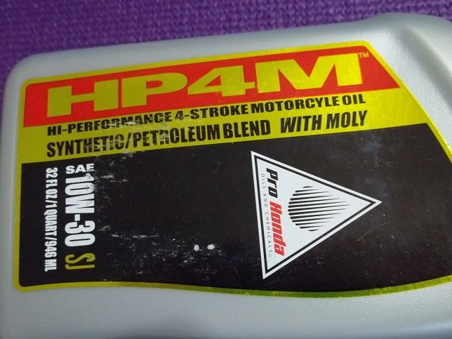

Please use the recommend Honda product when you can. There might be a good reason Honda want's Moly
- moly.jpg (205.02 KiB) Viewed 2327 times
- oil.jpg (206.88 KiB) Viewed 2327 times

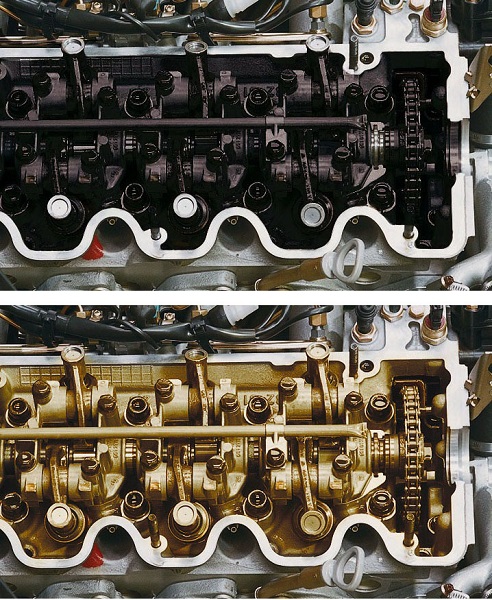

Will it help against photoshopping?
