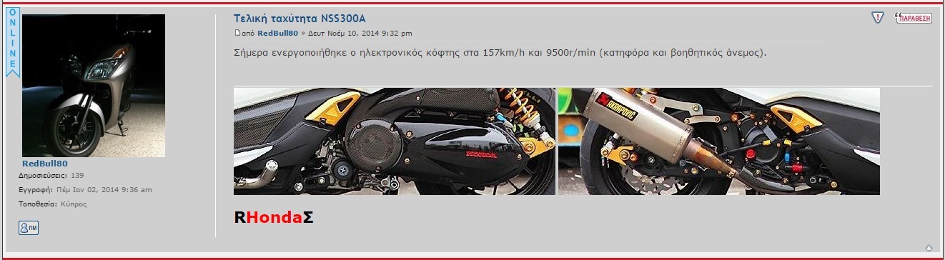

BRed, that's me posting in a greek forum... on the 10th of November... reaching 157 km/h@9.500 r/min where the rpm limiter was activated (on a downhill & with tailwind)! I did it two more times (always@9.500 r/min): 153 km/h and 155 km/h (different enviroment conditions).
- Honda Forza 300 Top Speed.jpg (135.11 KiB) Viewed 14135 times

Thanks....that's good to know!
9500 rpm!
the lighter the weights, the higher the shiftpoint and the higher the revs required to reach high gear (top of the pulley)...
most weight combinations (within reason?) will completely close the variator....eventually?
the trick with sliders and lighter weight combos is to get them to do it before your engine reaches redline!
That's fast for a 279cc!
Are you running stock weights? Any drive mods?
9500 rpm!
