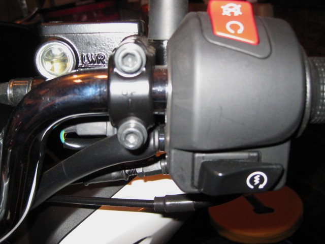

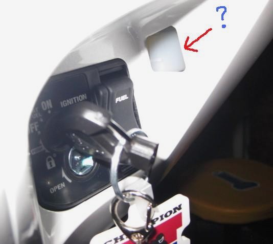

While taking pictures I noticed 3 things that seemed odd.
1) In the first photo the CBS brake fluid reservoir looks empty. I even lit it up with a penlight. No help. Could the fluid be THAT clear?? I even rocked the scoot. Nothing visible.
2) Same photo, there is No window "piece covering" the CBS brake view window (I had one on my 2011). I can stick my finger through the hole and touch the reservoir. I'm wondering if I'm missing a clear piece of plastic over it.

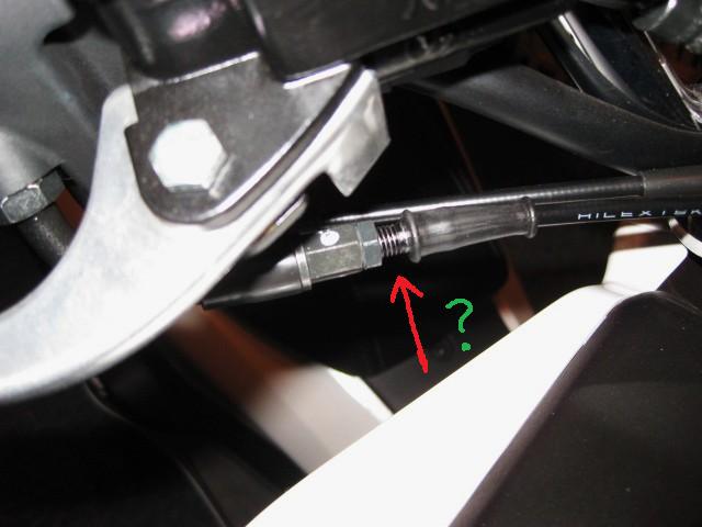

3) A cable coming out of the front brake/switch area looks like it needs tightening. Quite a few threads are visible and there's a white paint dot (Honda lineup mark? To where?). Should this be tightened all the way? Bottomed?

Two photos referring to questions I asked above:
CBS Reservoir View Window and Ignition.jpg (46.79 KiB) Viewed 5032 times
Under Frt Brake Lever, Should Threads Be Showing.jpg (45.22 KiB) Viewed 5032 times

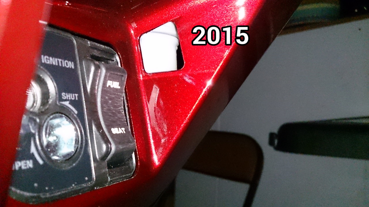

Hey there Whitenoise, my 150 came home last week. I just checked mine and the cables are from the throttle. I have no cover over the CBS reservoir either., there is fluid in there but it's hard to see.
Anyway everything works fine on mine.

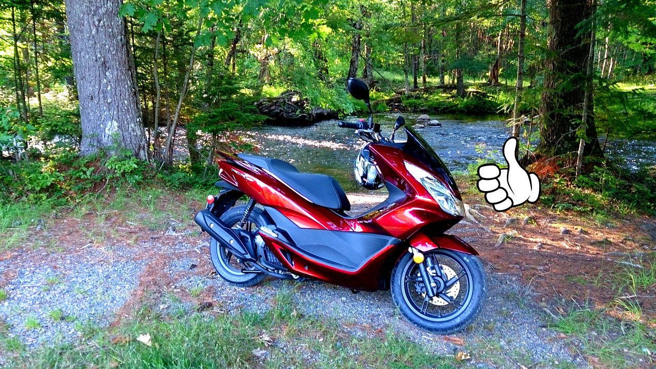

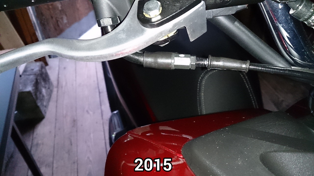

Here's a pic of mine.....

Wow, Redwing fast response! Great, thanks! Your bike looks amazing, great pic too! :P
Okay, about the CBS brake fluid window. Guess Honda doesn't think it necessary to cover it anymore.
I may concoct something on my own to cover it.
I can't see the fluid. It must be full to the brim. Who puts the fluid in? Factory? Dealer?
Wish it were easier to access the reservoir. Pulling front Tupperware off is not going happen. Not for this anyway.
Your cable seems to have More threads showing (7?) than mine (5?), but both dots are facing in the same direction. I'd feel better getting more input/conversation about the proper thread position/setting of this cable. If someone else happens to have a 2015 to look at, could you please look at yours and chime in? Is cable Factory set or dealer set?

Throttle cable free play is set at the factory, checked at p.d.i. and all services.
Number of threads showing is irrelevant, what counts is the free play.
And full and free operation at all steering angles.

Redwing, & gn2 all is good. Appreciate the input from both of you. gn2 you're right again! ;)
I was at my dealer yesterday (picking up my pre-ordered Service Manual) and decided to question them as well. I used their Black 2015 PCX on the floor as reference and pointed out my concerns (and then some, why not?)
The throttle cable was/is factory set. I was assured it was fine, he even explained the importance of the tension on the throttle cable. Then said it would be checked again at my 600 mile service for adjustment, if any.
Fluid in CBS reservoir IS there and filled to the brim. He had a penlight like me and flashed it in. It wasn't till he lifted the front end of the bike that I could see it. Being it is filled so high and having a Very slight yellow color to it, makes it extra hard to see.
About the missing CBS plastic/glass piece over the window? No more. A thing of the past. Had it on 2011 model, Now gonesville on 2015. Bub-bye. Knowing this, maybe I'll tap the reservoir with a screwdriver next time to see the fluid move (?)

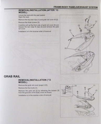

Some folks were curious about the New Service Manual, I know I was. Didn't know how Honda was going to handle this. Now I know. Picked my copy up yesterday, a 2013-2015 (Shared years) Svc. Manual (the one Honda uses).
Here's a pic of the Manual itself, and also a page from it showing you How plastic was removed "After 2013 model" and on "the 2013 model."
If available, I highly recommend getting the Service Manual, it will serve as an invaluable tool for as long as you own your beloved scoot :P

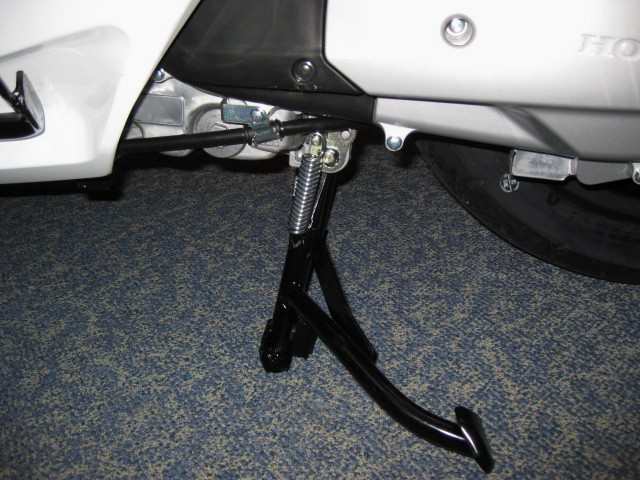

No Fear Center Stand 5682.JPG (117.48 KiB) Viewed 4944 times

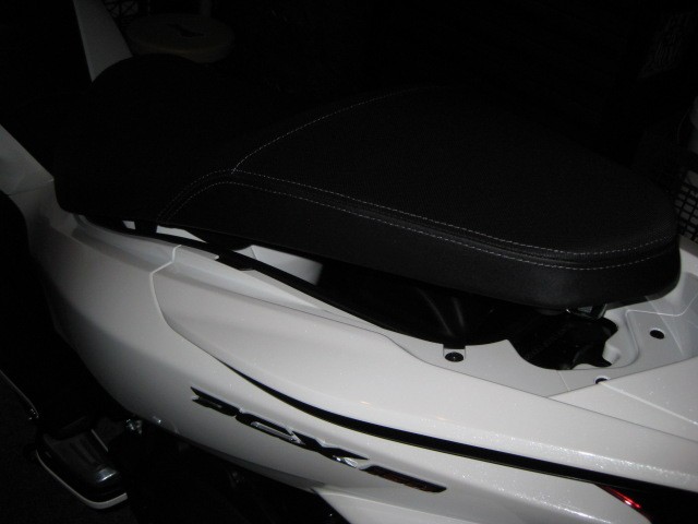

Lid in & Seat won't close 5669.JPG (58.41 KiB) Viewed 4944 times

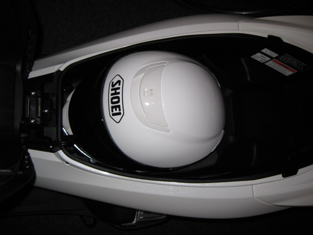

Helmet in 5668.JPG (64.39 KiB) Viewed 4944 times

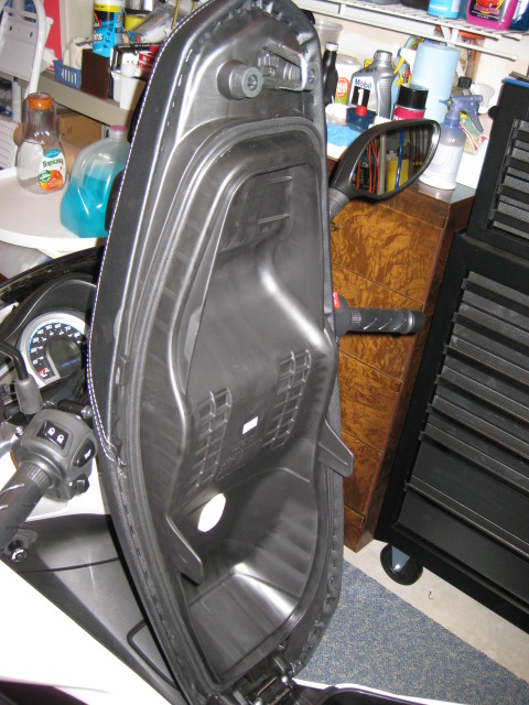

Underside of Seat
Underside of Seat

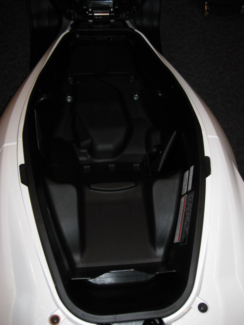

Storage Under Seat
Storage Under Seat

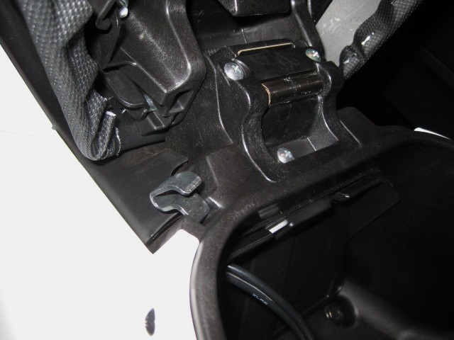

New seat hinge, battery cover, & helmet hook 5670.JPG (76.81 KiB) Viewed 4944 times

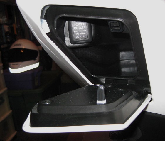

Deep glove bin with power outlet 5672.JPG (62.13 KiB) Viewed 4944 times

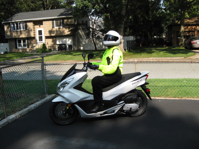

And, You thought I was Done :lol: WhiteNoise is Not Shy!
I actually got in one of these shots! Whoa WhiteNoise!
Don't Fence Me In! 5694.JPG (137.12 KiB) Viewed 4944 times

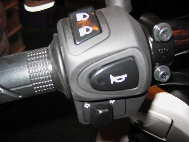

Light Switch, Horn, and Signal Switch.JPG (70.93 KiB) Viewed 4944 times
