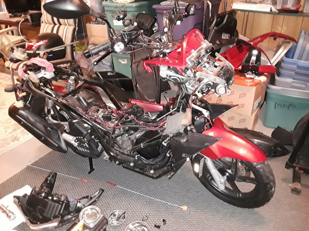

I recently fixed my headlight assembly so that it now has 6 useable lights. Here is a picture of how far I had to break down the plastics in order to get to the light assembly. :roll: Have fun. Shouldn't take too long. :lol:
My bike torn down.jpg (364.52 KiB) Viewed 34046 times

Not in the photo.
Fortunately.
But trousers must also be removed.
It's a Honda thing....

On the good side, I didn't have to remove ALL of the plastics. :-)

That is quite a lot LoL (although not all ...)
I would have done it if it was a year or two before i.e. when I was young
Perhaps it is my turn to contribute to the local garage industry

Dig the workshop. Great tutorial. The panels appear seamless so it's been difficult to know where to start.
Re: How-To: Completely Dismantle A PCX
Posted: Thu May 24, 2018 10:48 am
Start in the rear and work your way forward. When you get stuck pull out the service manual and look in the panels section (chapter 2).
