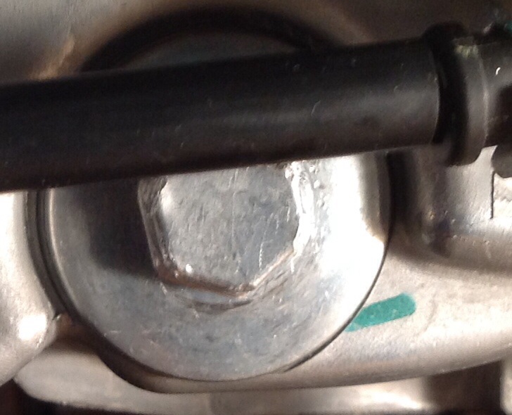

you you, You are right! I changed oil today, that's the good news. But damn! Take a Look at my oil screen bolt
Crap!
I read your previous post after my wrong doing
I did Not use a wrench/spanner on it First (curse again)...and the two "proper" sized sockets I used Didn't fit snugly! why? (what the __) I swear that damn bolt is tight as a ****(bleep this)****!!!!!
Color me Red!!
Can't get the bolt to budge! Now what? How do I remove it?? Help!! Anybody???
Guess I'm ordering a New Oil Strainer Bolt? Or assembly?
Me and the White....not getting along today
Color me Red!!

Looks like you used a twelve sided socket
needs to be a spanner or six sided. Have you tried a spanner on it. Looks as if it'll still work. Use an adjustable one and tighten it undersize and tap it on?
Don't worry there are still a few ways. I'd try them in this order but let's see what suggestions others have
Use a cold chisel or old screwdriver and hammer and whack it round
Mole grips
File a flat in it for a large screwdriver
Before trying any of these I'd also make sure the bike was warmed up and I'd give the cap a reasonable ( but not too hard) crack face on to free the threads.
Mole grips

Thanks for your quick reply and advice.
I'm calmer today. Life moves on (that sounds good, don't it?)
Here's my order of tool usage on the oil
screen bolt:
(Oh, the bike Was warmed up first as I drained the oil prior to this).
Ratchet with Six sided 17mm socket then 12 sided 17 mm socket. I tried both sockets with and without a short ratchet extension. No budging.
Then I tried tapping the ratchet arm (with a 6 sided socket on the bolt) with a hammer. OMG, right!?
No luck. All I accomplished was beating it up. These tools kept slipping off it's rounded edges.
Then only then, did I grab my stubby length gear spanner (same as word wrench in USA). I tried it by itself on gear end then reversed it to open end side and tapped again with my hammer. SOB won't budge!
I have to say, this alloy casting is Soft, it was chipping off in places & gathering on the cardboard in bits beneath it. So Sad.
It also angers me that the housing around this bolt is SO small that you can't turn a wrench around. Mad at Honda. Why such confinement?
"I've done" my oil change before, but I had my neighbor open this "problem" bolt then. This sure is one Tuff nut to crack!
I appreciate your suggestions and I am open to others. I can't get tuit today anyway....I'm off to Mom.
Hey! it Snowed here this a.m.......just a dusting. Guess I timed my service right, but still want to ride a bit longer. I've got the proper clothing 4 sure. Have a good day All!!

Its not a huge thing to worry about tbh. Change the oil frequently and it's not going to clog the filter. Ignoring it could be an option.
Re: How to: Oil Change for Honda PCX
If it's any consolation I nearly snapped of a plastic lug removing the plastics changing the rollers recently. Left a screw in!!
