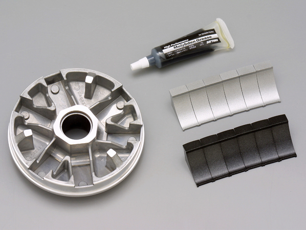

Please specify what kind of kit you're talking about? Upper or lower ?
- 79376f.jpg (162.31 KiB) Viewed 565453 times
- 76758_1_l.jpg (187.57 KiB) Viewed 565453 times
Mgalutia88
- Posts: 783
- Year: 2013 PCX 150
Re: Pcx Yuminashi Chainsaw 164!
The lower kit is what PCXdemon and I both use. I use the silver ramps for more highway performance. Vlad uses the black ramps last time we spoke.

Sorry OT. What is the difference between the silver and black ramps? I'm thinking more engineering rather than the results. What stops them rattling around? What are they made of?Pcxdemon wrote: I cant remember saying that...i also use silver ramps.

Glue the ramps in with hondabond ht or black rtv.
The ramps provide different powerbands. The black ramps are of more midrange and the silver ramps are for more top end power. With the silve ramps the variator is not in lockup until 65mph or so.
