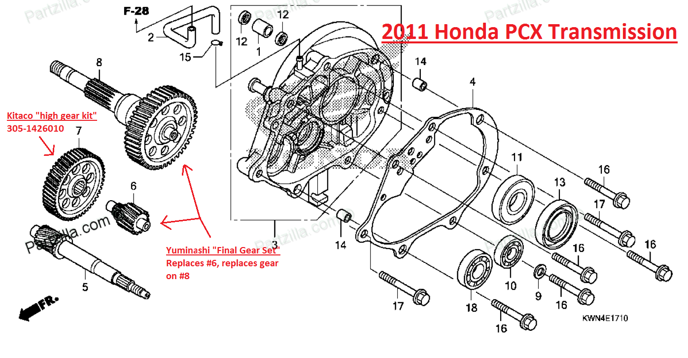

I made this diagram to make everything a bit more clear: The stock ratio for the set above is 13:47 (1:3.6), the Yumi (Forged Final Gear Set) kit is 15:45 (1:3). With that change, it would increase more than 12% cited earlier in the thread -- that would add 20% to the 125cc model. For my PCX and its current top speed with the bore kit, that would mean 85mph. That would be INSANE. Mind you, it'll make my speedometer even further off -- it will probably read around 65-70 at that point still.
While I'm at it, I calculated the 44t Final Gear Sprocket set vs. stock. The stock ratio is still 13:47 (1:3.6), and the other Yumi (Final gear Sprocket) kit gives 13:44 (1:3.38), or a 6.8% increase.
I went ahead and spent the $130 to buy the kit. I'll update back here how it goes, and will likely make an actual how-to for it; I didn't make a how-to for the Kitaco gear up kit.
