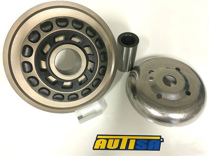

Anyone know this variator or have tested it?

robertinino wrote:Anyone know this variator or have tested it?
R
Much less expensive than J COSTA.
Other owners with other scooter brands have tested and say it's similar to J COSTA but without the problems of it.
BUT i have not seen a full report after 28.000 kms as we did to J COSTA so i can't say for sure.
I can say for sure that the set up i wrote above with OEM variator - 18gr Dr Pulley, DNA filter and ARROW 2 exhaust is very good and reliable 100%.
