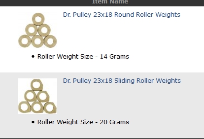

Re: Tuning the Forza 300 CVT
Would it make sense for me to mix these weights to get both acceleration and top end?
No problem if you mix them 2x3 pieces, the effect is the same as 6x 17g.
Accept then you lose the advantage of the lower starting gear that you get from the sliders. Just use a lighter slider as Mario has.Mario wrote:No problem if you mix them 2x3 pieces, the effect is the same as 6x 17g.
If you want better fuel economy use the mix...(no complaints with my 20gS/15gR)Kompact wrote:Would it make sense for me to mix these weights to get both acceleration and top end?
better acceleration use just sliders...
both ways will give the same top end.
