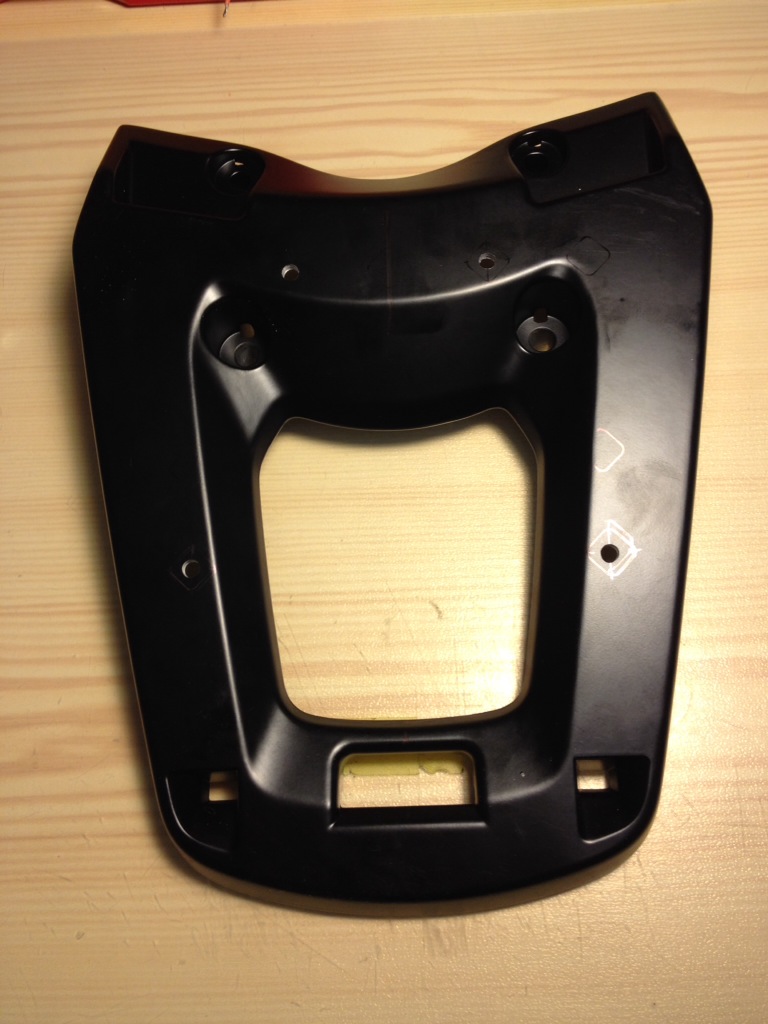

I bought the Honda Rear Trunk Base 08L70-KZY-910, and it is indeed very sturdy metal construction. I have not yet installed it because I haven't decided on which trunk to get.
I'm thinking, however, that the Monolock or Monokey universal bases can easily be installed by first drilling mounting holes through the metal Honda Rear Trunk Base.

Great idea! That plate is pretty heavy, but once you drill through, it would never let go! Let us know if you decide to go that way.

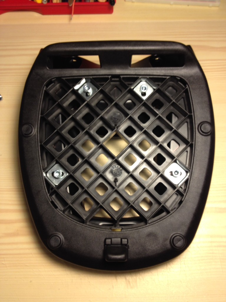

Hello all I've received Honda trunk finally today from US. I'm wondering how to mount the Givi base plate because point 11b of PCX commander photos is not so clear. I'm thinking about drilling the holes anyone already did it ? If so would you mind please to share photos ? Thanks.

BrAtKo, the mounting hardware that comes with the kit typically mounts to the baseplate without drilling. Do the holes not line up?

Pcx commander has used some different parts not included in honda kit and even in Givi kit.

The only hardware I don't recognize is on the bottom -- those brackets aren't the same. Typically, a washer and nut is included on the bottom, and they hold the case mounting plate to the rack.

maddiedog wrote:The only hardware I don't recognize is on the bottom
Exactly same on me.

I've already modified it by drilling four holes.

Hello all I've picked up mine pcx 150 2014 and finished mounting the box. First I've had to extend two holes with dremel grinder and all threads has been protected with thread locker.

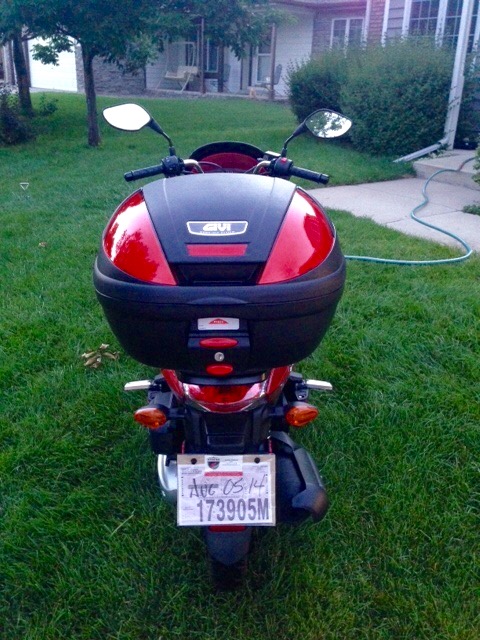

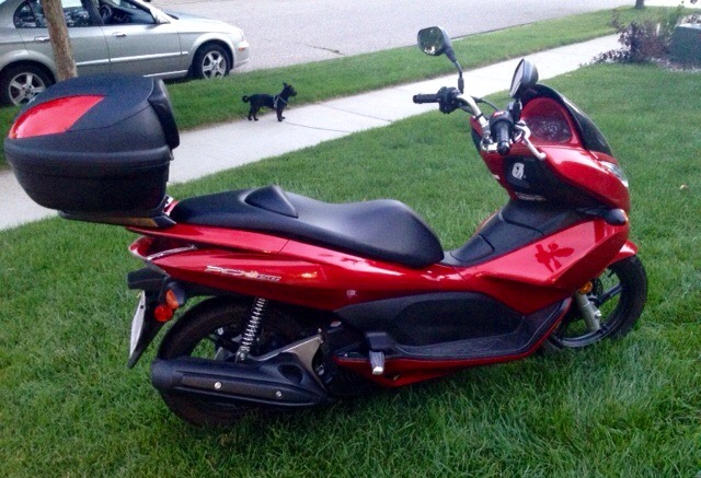

I just wanted to say thanks for all the info and part numbers/vendors. Here are some pics of a successful install after finding all the great advice!
Thanks.
