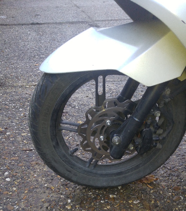

Installed EBC disc and sintered pads yesterday - i've only done the bedding in up to now following these instructions but now i see EBC have a different ones.
I advice you to get a new disc from EBC they are cheaper than stock and almost half a kilo lighter. Your old disc might be contaminated ( at least bead sand it)
Even if not broken in at this stage there is an obvious improvement when braking from 50 mph to 8, and after doing so a couple of times it increase even further ( instead of fading more).
Looking forward to install braided lines now.

It's been raining cats and dogs today - the sintered pads and new disc above are way better than stock in these difficult conditions and dry ones- no contest
