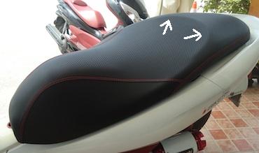

did you end up going with the seat from power by pcx? I have the same problem as you, removed the hump, added padding and recovered the original seat, but there is still a "ridge" there when i try and slide back a little bit. The following picture is the type 1 seat powerbypcx sells, and looks like this may present the same problem; does this "ridge/edge" the arrows point too press up against your tailbone? or is it far back enough that i could stretch my legs forward without rubbing and riding right up against it?depthman wrote:I've got my PCX150 tweaked, except for the seat! I didn't like the little hump, so I took it off, and had a local upholstery guy fill the hole with foam and recover. But where it was filled in was kind of a hump, and it was not comfortable on long rides! I'm thinking of ordering one from Thailand Powerbypcx, but, of course, there's no way to know about a seat until you sit on it! So, I'm wondering if anyone here has tried any of their seats? (I'm not riding in this cold weather, but I want to be ready for spring!) Thanks.

^^^ Good question

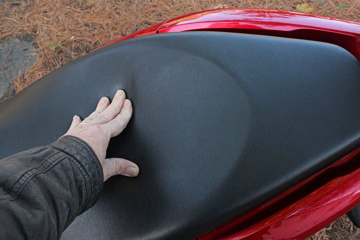

The problem was that before the ridge the foam was rising up (see photo- but hard to show), instead of flowing down, so my butt didn't sit well back there. So I ended up pulling cover staples on half the seat and cutting down the foam there, put in a thin dense piece instead and recovered (bought a pneumatic stapler at Harbor Freight for about $25 which worked fine). So this is better! I also picked up an AirHawk seat cushion (which has been well reviewed) but haven't tried it yet. Only been on a few short trips as Spring still has not arrived here!loudgonzo wrote:did you end up going with the seat from power by pcx? I have the same problem as you, removed the hump, added padding and recovered the original seat, but there is still a "ridge" there when i try and slide back a little bit. The following picture is the type 1 seat powerbypcx sells, and looks like this may present the same problem; does this "ridge/edge" the arrows point too press up against your tailbone? or is it far back enough that i could stretch my legs forward without rubbing and riding right up against it?depthman wrote:I've got my PCX150 tweaked, except for the seat! I didn't like the little hump, so I took it off, and had a local upholstery guy fill the hole with foam and recover. But where it was filled in was kind of a hump, and it was not comfortable on long rides! I'm thinking of ordering one from Thailand Powerbypcx, but, of course, there's no way to know about a seat until you sit on it! So, I'm wondering if anyone here has tried any of their seats? (I'm not riding in this cold weather, but I want to be ready for spring!) Thanks.

My stock seat with the hump removed has that issue, due to the shape of the underlying plastic. Its ok for short commutes but starts getting uncomfortable on day tours. It would be fine if I wasn't so tall (6' 3.5"). If someone brought out a decent seat for tall riders without a ridge I would get it, especially if it also allowed my XL helmet to fit better under the seat!

First, I have not been in the PowerbyPcx shop but I have been into a few other shops around Thailand. Here are some of the observations I have had. Many of the aftermarket seats for sale are original factory seats that have been recovered minus the hump, others are made with a smooth seat pan and would not have the hard ridge you are speaking of. Some have the original rubber waterproof seal included some don't. The seat humps can be cut out/removed and additional foam added to compensate for the space (I did this and filled the holes with an epoxy material).
If you are interested in buying one here be sure to ask for one with the smooth seat pan and with a rubber waterproof seal included. I'll try to take a few pictures tomorrow showing the differences in the seat pans.

Hey I will let everyone know in a few weeks. I just ordered this exact same seat yesterday.loudgonzo wrote:
Did you end up going with the seat from power by pcx? I have the same problem as you, removed the hump, added padding and recovered the original seat, but there is still a "ridge" there when i try and slide back a little bit. The following picture is the type 1 seat powerbypcx sells, and looks like this may present the same problem; does this "ridge/edge" the arrows point too press up against your tailbone? or is it far back enough that i could stretch my legs forward without rubbing and riding right up against it?
