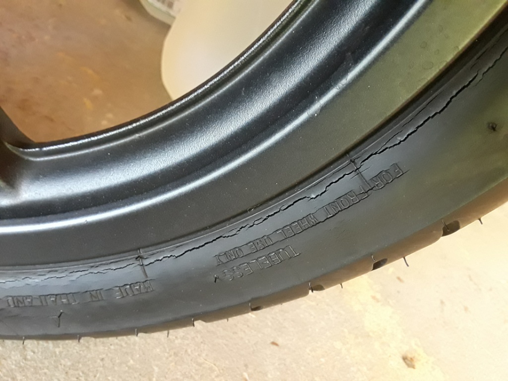

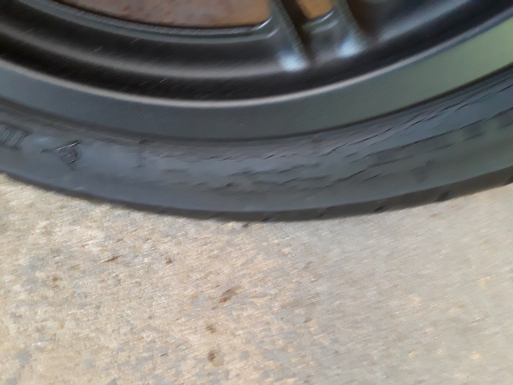

I was about to take my bike out this morning when I noticed what look like cracks in my front tire. Is the tire still safe or does it need to be replaced. This is the tire I am considering replacing with a larger tire, but I can't find any in Michelin City Grips.

I would say that tyre needs to go.

I would definitley get rid of that

Ok, I just ordered a replacement tire from Revzilla. They have the best prices. ($50.34 and free shipping)
I ordered a Michelin City Grip 90/90-14.
I had hoped to hold off until I could find a larger tire for the front, 100/80-14 perhaps, but no website that I could find had them in Michelin City Grips. Well my wife's bike has the 90/90-14 on it and it rides well so I guess it will be fine.
Believe it or not that is the original tire that came on the bike. I bought the bike new 4 years ago, and it only has 5,500 miles on it, but who knows how long the tire was on the rack before going on the bike. Still, that is disappointing.

what was the date stamp on your tires?

For anyone not familiar with date stamps on tires:

Looks like sunlight/ozone damage

The tire says MADE IN THAILAND and the date code is 4812. That would be the week of the end of November and the beginning of December. So, I purchased a 2013 PCX, still in the box, in May of 2014 and the tires were made in 2012. :-/

Mel46 wrote:The tire says MADE IN THAILAND and the date code is 4812. That would be the week of the end of November and the beginning of December. So, I purchased a 2013 PCX, still in the box, in May of 2014 and the tires were made in 2012. :-/
So a year and a half. Not unusual. As they were still boxed I suspect it's the sun in the recent four years that is the issue. But it's your call.

The tires, on the other hand, have plenty of tread left for ~3,500 miles.... but I just recently noticed that my front tire has cracks all around, while the rear tire has none. Definitely need to replace that tire ASAP, but I've still been riding it wide open every day for about an hour, round trip.

I just replaced the front tire on my '13. 12000 miles. Pretty much to the wear bars and some evidence of cracking at the rim. I'm sorta glad we have a motorcycle inspection requirement here - I probably would have run it until I had a problem.
