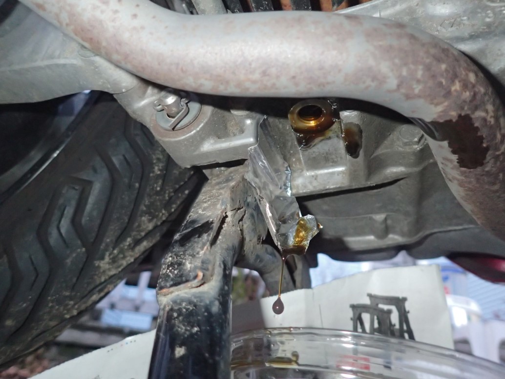

Can we talk about the odd placement of the drain bolt? What do others use as a drain pan? I had on old plastic dish pan I always used on my other scooter. For the pcx it barely catches the oil and yes I had oil everywhere when I was done. Thankfully, I only have to do that once a year!

I did read about changing the oil before I did the deed, and was warned about the mess. I put a bit of aluminum tape on the motor to help direct the oil away from the kickstand and toward my collection dish. It worked OK, and is still stuck on a couple years later.
- oil drain tape.jpg (142.74 KiB) Viewed 750 times
