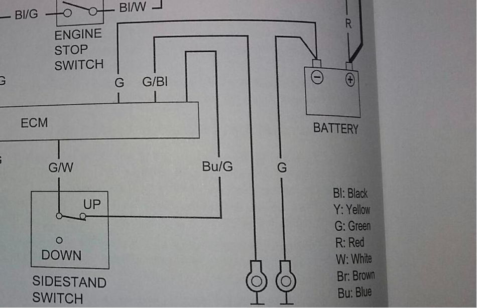

similar problem. parked the bike up, 2 hrs later won't start, or turn over. checked the side stand kill switch found that the 2 wires + sleeve had broken/ worn though on the frame. Easy fix, twisted the wires together . or so i thought, now turns over won't start. no fuel pump noise.
speedo needle swings, check light comes on then goes out.
the 2 wires go directly to the ECU. Is there a way to check the ECU.
All fuses good.
All fuses good.

strange that it wont start when you connected the wires
you could remove the wires on the ecu and spray wd40 and reconnect and try again
Re: Won't start. New battery. All lights turn on except head
Thats's what i thought. The kill switch isn't fused, the wire [s] will have gone to negative on the frame, since they go to the ECU i'm assuming it's blown something in there. doesn't seem to be a way of checking it. Got the bike back home today , will check for a spark and power to the fuel pump first.
- Screen Shot 2019-06-29 at 08.06.59.png (455.01 KiB) Viewed 3314 times
Check your wires for continuity. The green is always ground. Both sides of that switch go to the ECU. See if you can pull the plug to the ECU and make sure the wires have a good connection to that plug.

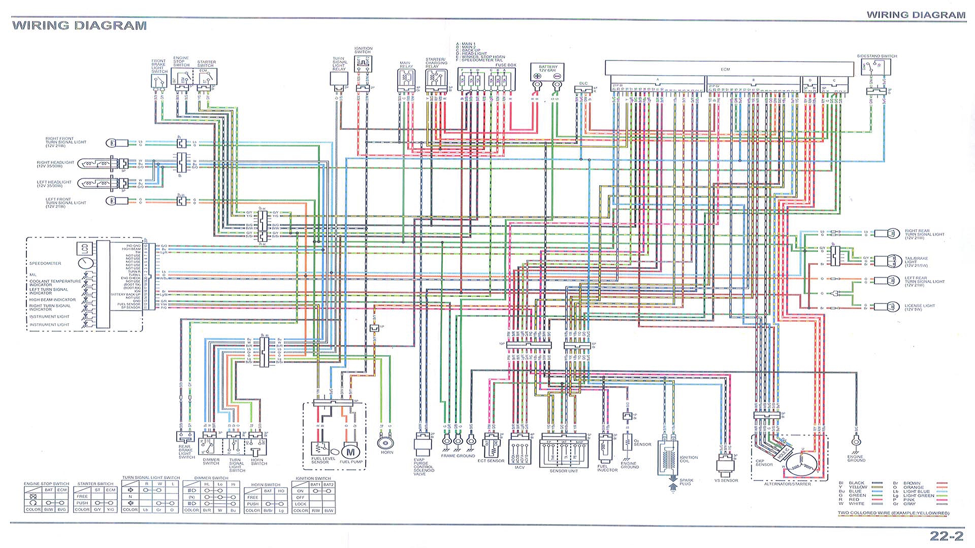

There can also be multiple issues at the same time, so check your other switches as well (such as the left brake switch, which for some reason has more problems than the right one most of the time). Look at the entire wiring diagram to trace down possible electrical problems. Definitely check all of your fuses first.
You may or may not have this already, but here is another copy, just in case.
