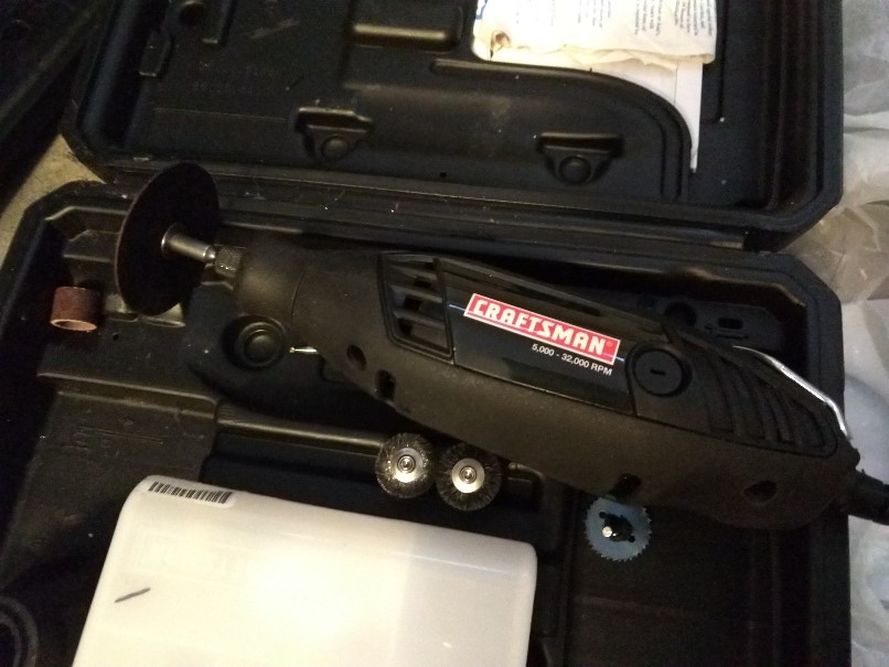

Wait...
Dremel with a smaller wheel than pictured.
Now
Next, hammer time.

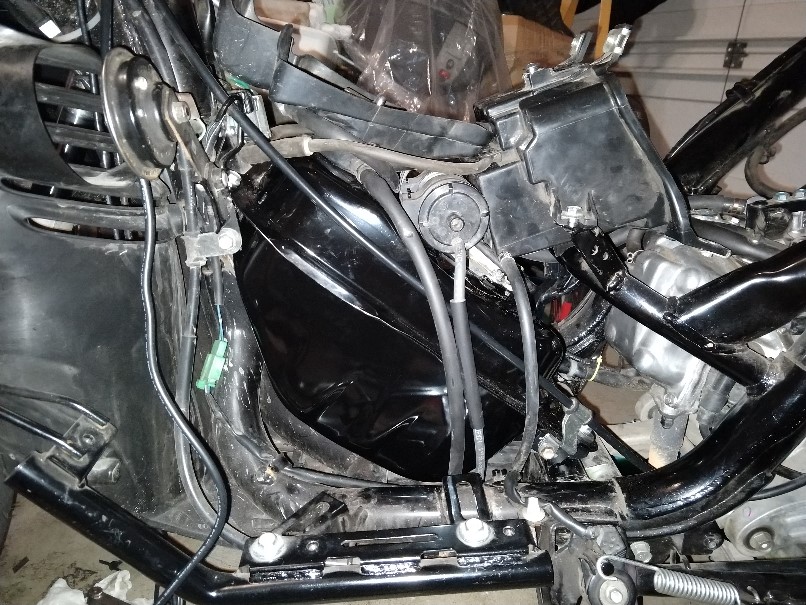

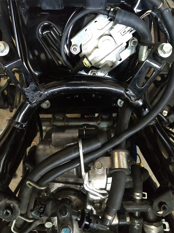

Here are a couple pictures of my progress. Will do a How to guide later.

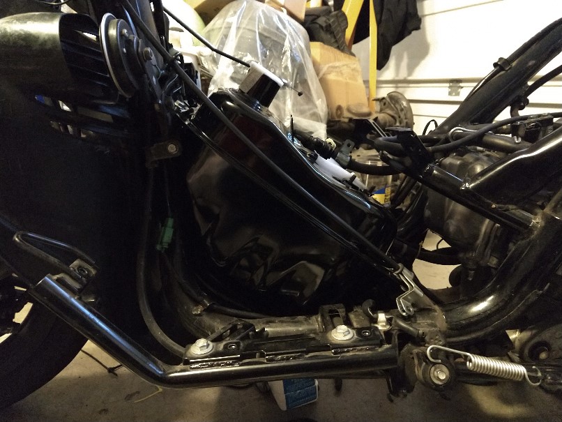

Re: My attempt to retrofit the bigger OEM fuel tank into 201
Posted: Sun Jan 07, 2018 7:30 pm
by Gil
View of brackets that where cut, my shoddy new brackets and paint. :)
Posted: Mon Jan 08, 2018 8:14 am
by Gil
The tank is in and it looks like everything else will bolt on with no issue, we will see.
Gil
Posted: Tue Jan 09, 2018 6:34 am
by iceman
Is the fuel cap going to be at a steeper angle than usual (will the pastics fit around that) - trying to make sense from the pics :)
Posted: Wed Jan 10, 2018 2:28 am
by Gil
iceman wrote:Is the fuel cap going to be at a steeper angle than usual (will the pastics fit around that) - trying to make sense from the pics :)

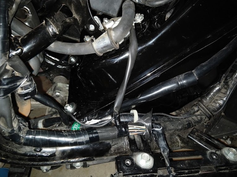

It doesn't look like it, but I won't know until I start putting those panels back on. There are little details like extending the fuel pumps wire harness, so that it's slack is like stock, that come up as I continue assembling it. I'm cleaning up some wiring I added to the scoot at the moment, so assembly has slowed for now. I'm wiring up the LED drivers for the headlights and the arduino controlled daytime running lights. It's much easier to do electrical wiring now that all the panels are off.
Here is the stock fuel pump harness. It's stretched a bit too much, so I extended it to avoid future problems. The picture is of the stock harness.

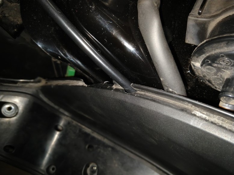

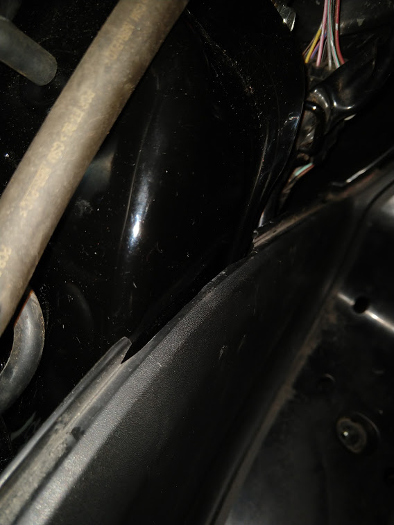

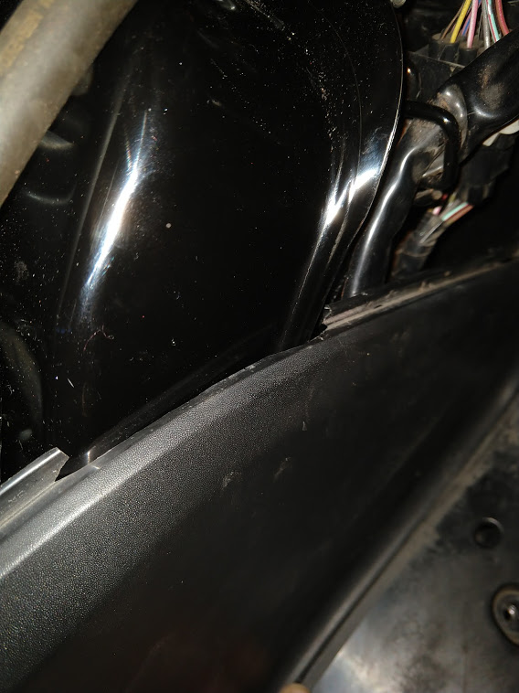

Side Panels
In the following pictures you will see the final look of the side panels. I needed a couple of millimeters shaved of both sides.
All the panels bolted back up like OEM. I was planning to add some electrical tape between the panels and the tank so that the paint on the tank wouldn't be rubbed off, but forgot to.
On the right side, I had to shave some of the plastic where the wire harness passes by.
right
right

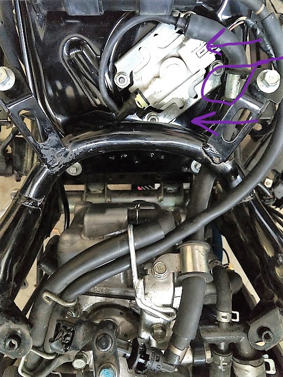

Fuel line
When I plugged in the original fuel line, it stretched a bit too much for my liking. I added a bit of slack by bolting the fuel line mounting bracket, close to the gas tank, more towards the inside and twisted it a bit. I believed that it helped, but I'm still concerned.
I did buy the fuel line from the 2015 model year, but it was a bit too long. It turns out that not only is the spout from the fuel pump assembly different, the fuel injector is too, the fuel injectors spout points back towards the rear tire. I left the original fuel line installed. I'll be checking the fuel line for defects on future maintenance checks.
I need to wash my scoot, it's dirty. :)
Gil
Posted: Fri Jan 19, 2018 7:54 pm
by Gil
PCX150Rider wrote:Did you end up installing the 2015 fuel line and just cutting it to fit?
Nice job! 8)
I left the original one on, I just added more slack by adding spacers to one of the fuel line mounting brackets.
I think it will be OK.
I mounted the bracket circled in purple to the inside of the chassis mounting point and added a spacer. I also twisted it counter clockwise a bit. I don't have a before and after unfortunately.
