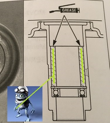

Neither of the two bearings in the 'face set driven' are sealed bearings so you must pack them with the proper amount of QUALITY grease. We need a grease that won't easily melt down in hot temperatures staying between those bearings in the summer and NO you don't have to disassemble the 'face set driven' to grease it. You simply put the grease between the needle bearing and the roller bearing by hand and no more than 7 grams. If by chance you get pre packed bearings with grease I would not like that because who knows the amount and quality applied?
This is not hard and I wouldn't trust the gorillas to get this right either, just follow the SM yourself.

Let's get this right people 8) this is how we pack em.
Don't learn a lesson the hard way like I did and put too much grease which will end up on your "clutch outer' race. I had to use a heat gun to bake the clutch shoes after sanding each shoe to get back a smooth, shudder free operation. Plus I melted all the old grease out of the face set driven and started over with the proper amount of grease. Not complaining, it was a learning experience :lol:
