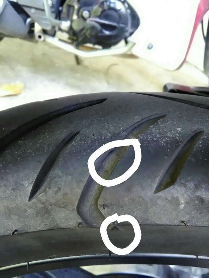

There are the wear bars one can use for reference if your tire needed replacement. Usually tires will have arrows to tell you where the wear bars are. Once you've reach the wear bar or it's almost visible, it is a good time to change your tires.
This is my rear at 11,200 kms..

Is that a City Runner tyre? It certainly does look excellent for 11,200km. It would be interesting to know if others are getting high miles out of them as well; as I understand it they're a pricier tyre, but if they're going to go a lot further then obviously that makes them better value for money than some. We don't seem to be able to get them here in NZ - seems like we can only get a couple of tyres, and none are particularly exciting (but seem to go OK all the same)
I'm familiar with wear bars, but I'm wondering how reliable they are since they're usually positioned part way around the "arc" of the tread and therefore it seems to me that the reliability of the indication may possibly depend on riding style. I would think that someone who spends a lot of time with little leaning would wear the centre of the tyre (ie the dangerous part) more quickly before the wear bars had a chance to "catch up". They may do a better job on that type of tyre though -- I just remember checking mine and didn't think they looked as relevant.

Theyre the IRC that came with the bike. SS560 ?
I believe there are two wear bars indicator one is for the center and another one is for the sides. I'll take a look again.

THanks - I'm quite curious. Is that a centre groove in the tyre? - I've only ever seen that on front tyres; we're talking rear tyres here?

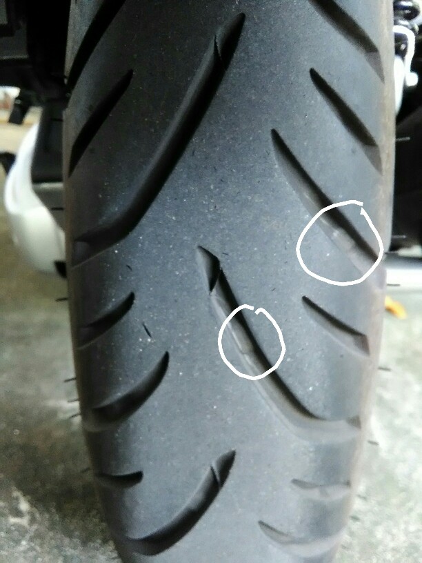

Here's another shot of my rear tire showing both wear bars (center and side). It's barely noticeable but it's there and will become more visible once you wore your tire significantly.
@TheMaverick
Treads overlapping in the middle, but no center tread like the one in front.

Ah - bingo. Thanks for that - couldn't quite get my head around the perspective of the first photo. Looks like a nice tyre - wish I had more choice over here in New Zealand
