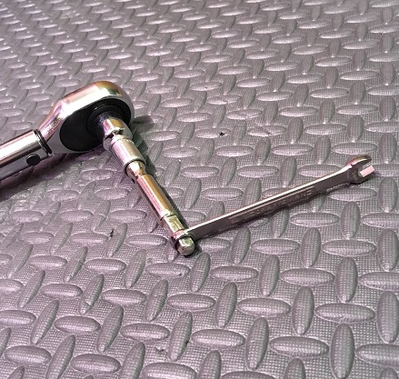

I know we are little help to find it, and I feel the pain for something that Honda claims needs doing that most likely doesn't. The ability to apply a torque wrench to this lock nut is tricky. Even the SM shows a 9m box end wrench on the lock nut. So how did you achieve the 7 ft lbs to this lock nut given the special tool it would take? Was it something like this...
Chief is dying right now looking at my tools, but how did you get this done?

That's in Newtom Meters only, so as not to insult your itellgence you do know you needed 10 Nm to get 7 ft lbs right?
10Nm= 7.375621ft-lb
And to be clear you had to rig something up like I show to get the torque wrench to work on a box end wrench... correct?

That is incorrect, you must hold the stem with a small wrench like in the picture to the adjusted specs you found with the feeler gauge while you tighten the nut to 7 ft lbs. Here is where things went bad for your engine. I have no understanding of what this did to the valves at this point but I suspect you need to take it in. And thank you for admitting the details. It takes a big man to follow up with a post like this. It can scare the crap out of folks doing this work and we must have conclusion.
..... am I correct that the torque wrench needs to be at a right-angle to the box wrench in order to get a correct reading? I'm almost certain that 'back when" we were re-torquing Norton heads and their mix of both head nuts and bolts (some of which being recessed in the side of the cylinder) we had to do this. I THINK we had to keep it at an angle to get it correct.
Also, note that those instructions from Honda mention a critical step - to oil the threads, so the measured torque is from a lubed surface, not a dry one.
