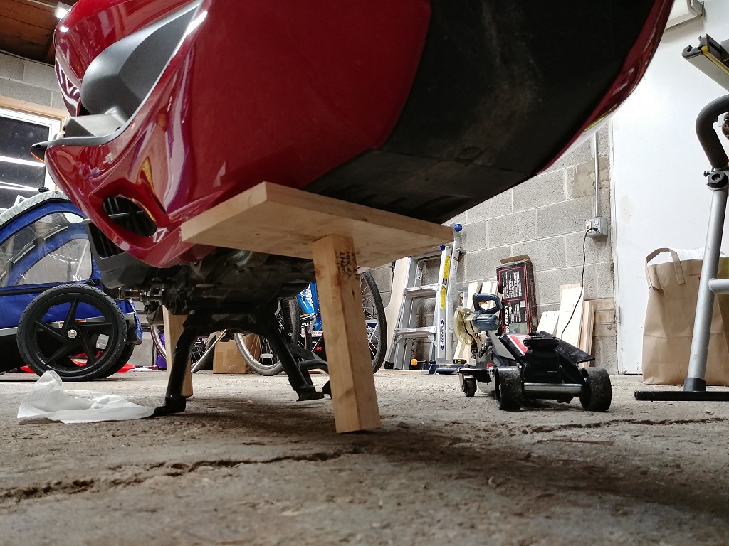

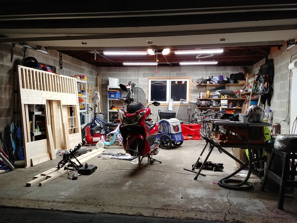

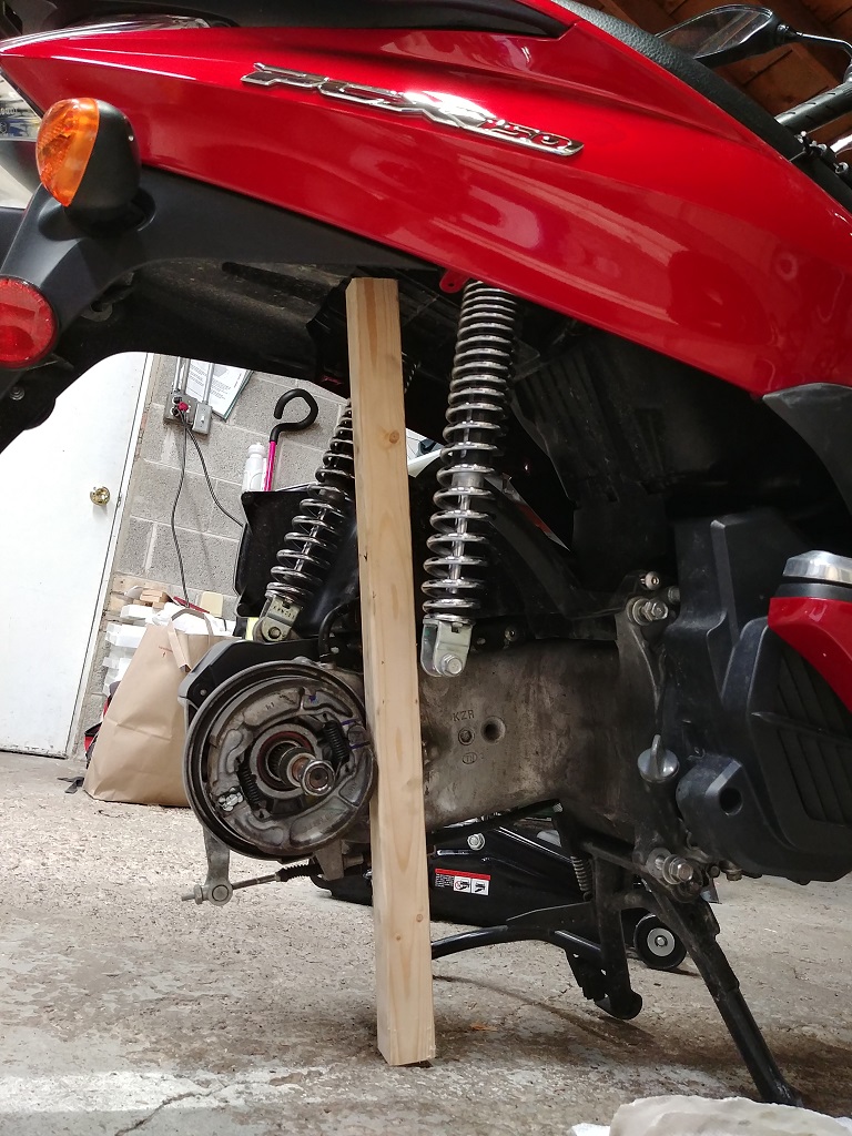

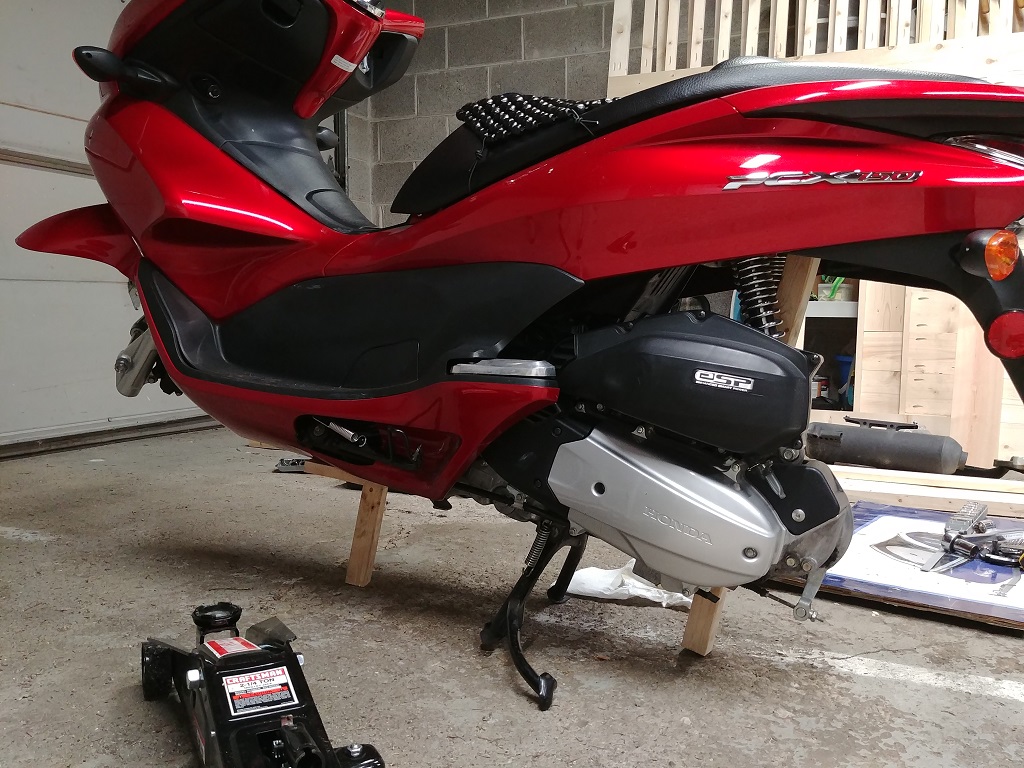

Well, I wound up doing what I tried last night, only I cut a 2x2 to replace the jack for holding the front end up for a couple days while I wait for them to mount the tires.
I lifted the front end off the jack while my son positioned the prop according to my instructions.
Looks a little dicey, but the floor has LOTS of friction, as you can see, and if no one bumps it, it'll be OK.
Now, to see if it'll be on its side in the morning, hehehe.
- Front view
- 20170713_214033_HDR.jpg (397.12 KiB) Viewed 2866 times
- Almost looks like it's flying...

- Front prop
- 20170713_213751_HDR.jpg (332.5 KiB) Viewed 2866 times
- Rear prop
- 20170713_213739_HDR.jpg (338.13 KiB) Viewed 2866 times

by the way, looking at my post above, the one with all the pix, the 2x2 supporting the back of the bike was totally unnecessary. When it's on the center stand, it's pretty front-heavy. After removing the rear wheel and muffler, even MORE so.
I was afraid I would need to have the front end up several inches, so the tire would clear the front fender. But this was more than enough. Skip the rear prop, if you do it this way.
