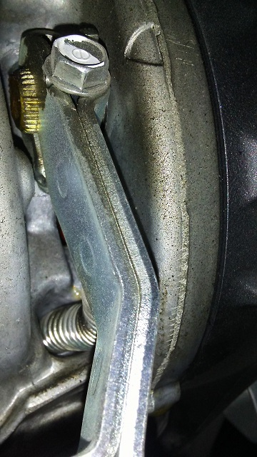

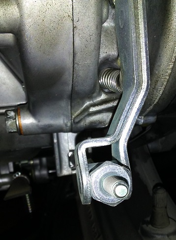

I was going to drain and refill the rear case and decided to take a couple more shots. I think the oil is coming from higher up than the upper fill bolt. I hope the pictures show what I was seeing.
I think it is coming from around the brake lever bar or directly above it.

Ok..this can be an easy fix or a pita repair.If it is not coming from the drain bolt,it looks like there is some seepage in the seam where the gear case mates to clutch housing.You can try tightening those bolts down a bit more.Snug em up real good, especially at the bottom.I suspect they might be loose.Clean real good run awhile and recheck for leakage.If tightening doesn't solve the leak it could be the gasket in between the two halves.In which case major disassembly is required to replace the gasket.Not a big deal,but if under warranty,let them fix it.Its probably a torquing issue or failed gasket.Try tightening first.

100 miles to closest dealer..A slight turn of a wrench to snug up anything loose won't void any warranty.A simple check will never void any warranty.If he prefers to travel the 100 miles,time off,fuel cost,etc,etc that of course is his choice.But if the dealer only puts a wrench and tightens it up he will look offly silly.Nobody is saying to go balls to the wall with the wrench and breaking anything.. Remember,it's 100 mile trip..I would give it a go..His call.
