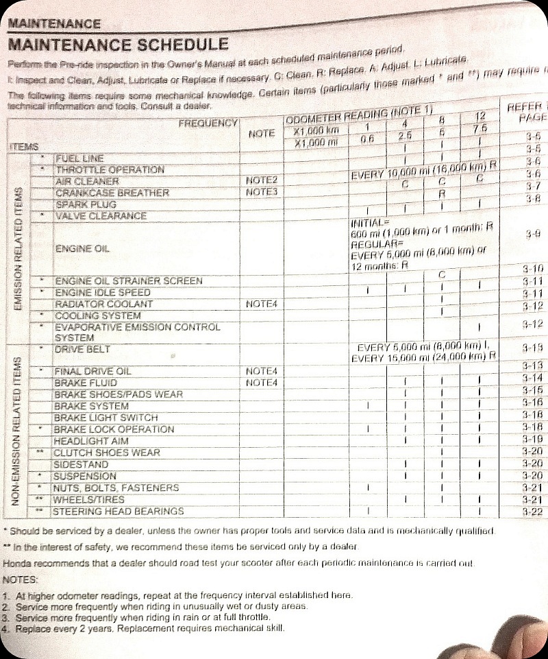

2013 maintenance sheet.jpg (373.08 KiB) Viewed 6085 times
This is the maintenance schedule for my 2013 model PCX. I know that the newer ones have some changes, but this should give you an idea of how much really has to be replaced during these visits to the mechanic.
I = inspect
C= clean
R= replace

Mel46 wrote:I believe it is called a screen, not a filter, so you don't have to replace it with a new one. You can pull it on the first and every other oil change after that. The first go around there will be some small metal particles in it from break in. After that I doubt that you will find anything in it, but go ahead and rinse it out ever so often. It still only takes an added minute or two.
Strainer screen according to your manual :D
Which is a sieve but it doesn't sound so technical :lol:

I'm currently on my 600 mile mark on my 2019 PCX 150 and I plan to change my own oil. Question is, do I change the engine oil only or do I need to change the transmission oil as well. Manual doesn't mention valve clearing, but this forum does. Do I need to do that now? Thanks!
Re: 600 miles service check up
Posted: Fri Oct 25, 2019 8:39 pm
Bronxcat wrote:I'm currently on my 600 mile mark on my 2019 PCX 150 and I plan to change my own oil. Question is, do I change the engine oil only or do I need to change the transmission oil as well. Manual doesn't mention valve clearing, but this forum does. Do I need to do that now? Thanks!
Opinions will vary. Mine is yes to the oil, no to a mechanical valve check, yes to a common sense one.
