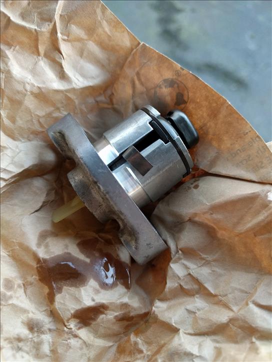

- Gil
- Posts: 623
- Location: Watsonville, CA
Re: Tapping noise coming from bottom end of engine
Did you ever take a look at the timing chain tensioner. My scooter made a similar sound and it turned out to be the timing chain tensioner.
Yes I've looked at it as intaken it out and looks as it works as it should.
Correct me if I'm wrong but if timing was a problem bike wouldn't start smoothly and noise would differ when operating throtle as in there would be acceleration and deceleration in timing. But will check it too since I've spare one.
Thanks for advice
Thanks for advice
The chain tensioner has a spring in it with a one way action on the plunger (rod/thing). On mine the spring had broken and the plunger was all the way in. The bike still ran and had full power, it just made that same noise. So with a loose chain the bike will still run. If the chain for some reason jumped a tooth or two on one of the sprockets, then the engine might have trouble starting or loos of power.Dragon_uk wrote:Yes I've looked at it as in taken it out and looks as it works as it should.
Correct me if I'm wrong but if timing was a problem bike wouldn't start smoothly and noise would differ when operating throttle as in there would be acceleration and deceleration in timing. But will check it too since I've spare one.
Thanks for advice
Gil
- holiday-pics-1_4.jpg (55.4 KiB) Viewed 5313 times
Sounds like timing or exhaust gasket missing to me. I like Gil's suggestion of checking the tensioner if you're confident it isn't valve noise. Badly adjusted valves make a tapping noise too that sound like that.
When you took the head off and did the cylinder, did the cam chain guides look worn? Did you readjust and tighten the cam chain tensioner before assembly? Same part as in the above picture, here's what it looks like fully extended:
This post: http://hondapcx.org/viewtopic.php?f=3&t=2939#p61935 (start at 4 or 5 pics in) shows how I retightened the tensioner during assembly. The PCX will make tapping if the chain has too much or too little slack, sometimes rasping if you rev hard and chop throttle.
Maddiedog
100% sure valves are done correctly. Had them adjusted three times after noise started and three different guys with mechanical knowledge similiar to mine (Im a car mechanic after 5years technical school and always worked with cars/bikes as a hobby (got bmw e30 with 4.4V8)) had a look to double check I've done it correctly.
Cam chain guides looked all good.
Tensioner as far as I'm aware is spring loaded, you undo it by turning anticlockwise and it stays in this position, then when touched or turned slightly clockwise it adjusts itself back to tight position. (please correct if I'm wrong)
A lot of plans for next few weeks (valentines day, my mum is flying over for 8 days, got to do some write ups for my NVQ, etc.) but I'll be taking loads of photos next time this engine will be pulled apart and will put spare tensioner and both guides from my spare engine.
But first will just change head to eliminate valves and springs.
Few more times and I'll be able to give info on how to strip engine and put back together over the phone. I know every bolt size on bloody thing now.
