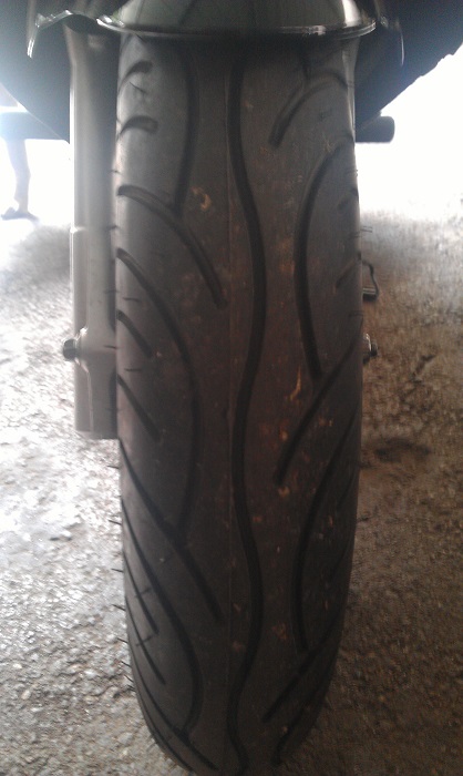

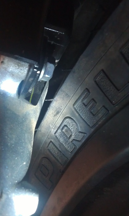

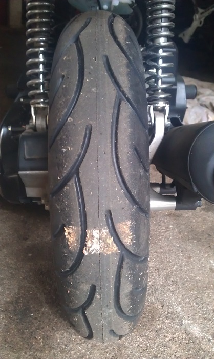

Well, I got my FAT tires on
120-70-14 and 140-70-14, and they barely fit...
the front side "hairs" actually just touch the fork legs, and the rear tire almost touches the engine case
And these sizes are as big as you can go on a PCX with stock rims and spacing.

I liked the tread pattern so I ended up getting a Pirelli GTS 23 and 24.

Can you get some pics from further out?
Does it handle the same?

Yea picture from a distance is required. Also i reckon 120-70/14 for the rear and 100-90/14(the rear tyre) for the front would be safe option and reasonable upgrade..
Has it affected performance in any way,good or bad..?
Cheers
Cheers

Re: Wider Tires
More pics when I get a chance... HUGE difference on rough roads and off road now
You can take pot holes and speed bumps with ease
So much more "soft feel"(same air pressure as stock).
Handeling is about the same, but you can take rough corners faster it seems
I was actually thinking about getting a 120-80(front tire) for the rear, but i'm happy with my selection.
