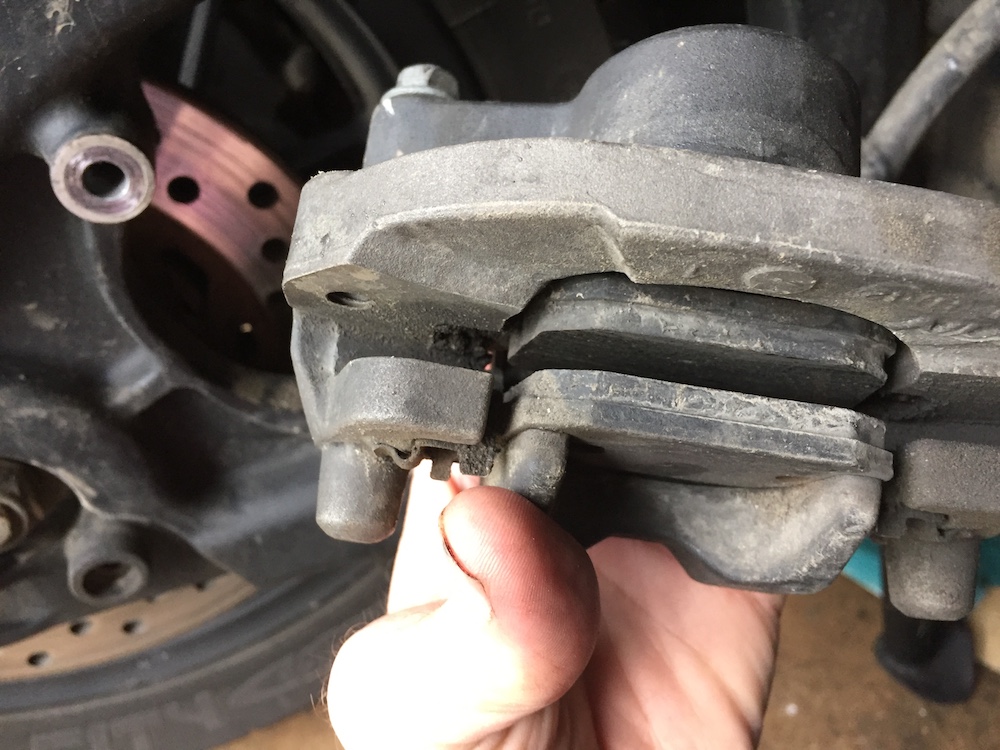

davenowherejones wrote:I finally had the parts I wanted for my Forza after a few tries. I pulled the rear calliper off and the brakes were ruined again. The inner pad was down to the metal and the outer pad was almost brand new.
What causes the calliper to stick like this?
The pads seize in the slides and don't release correctly. Cars have similar problems.
Corrosion builds up under the steel slide jamming the pad from sliding. Applying the brake pushes the pad onto the disc and it doesn't release properly, hence premature pad wear. The piston side it usually the worst.
The only way to stop this is to maintain the brake regularly but it's not easy on a forza unfortunately.

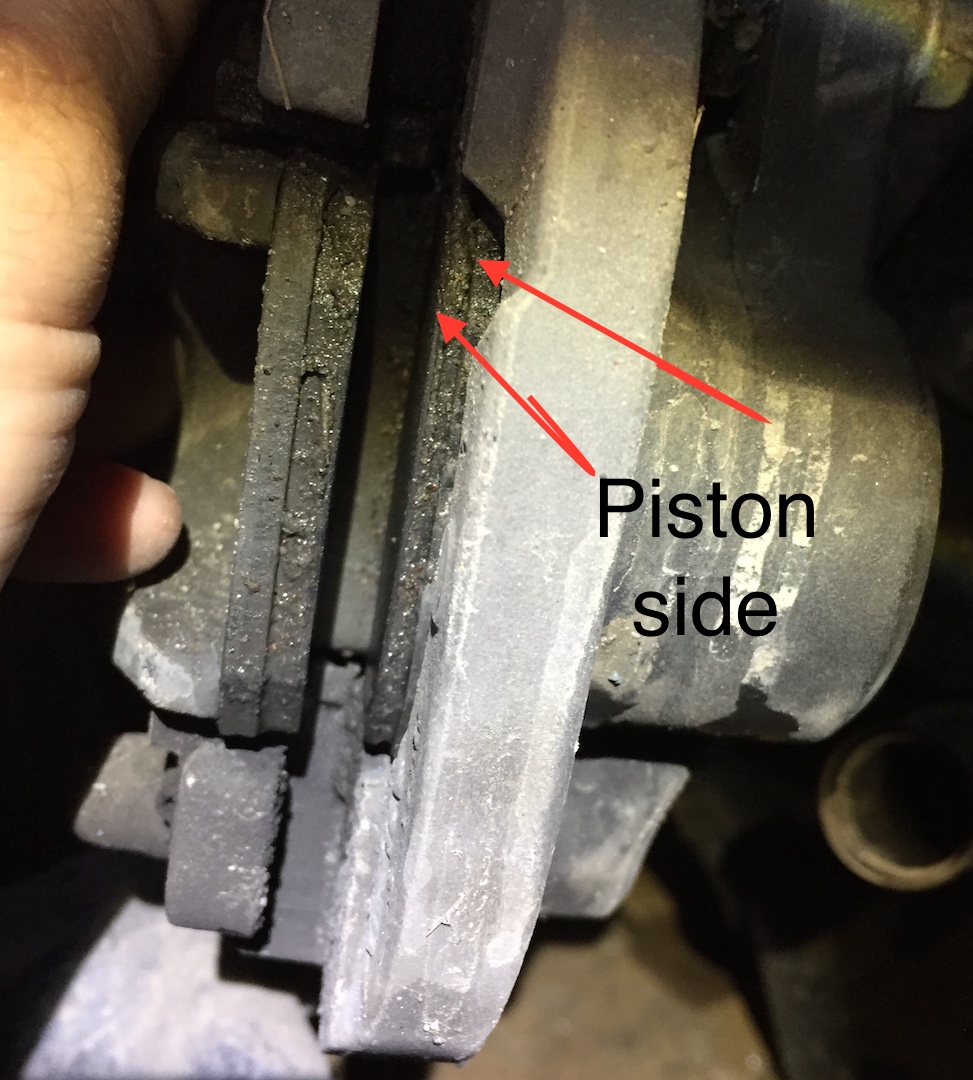

These are my last set of rear pads. One is practically new and the other is down to the steel.

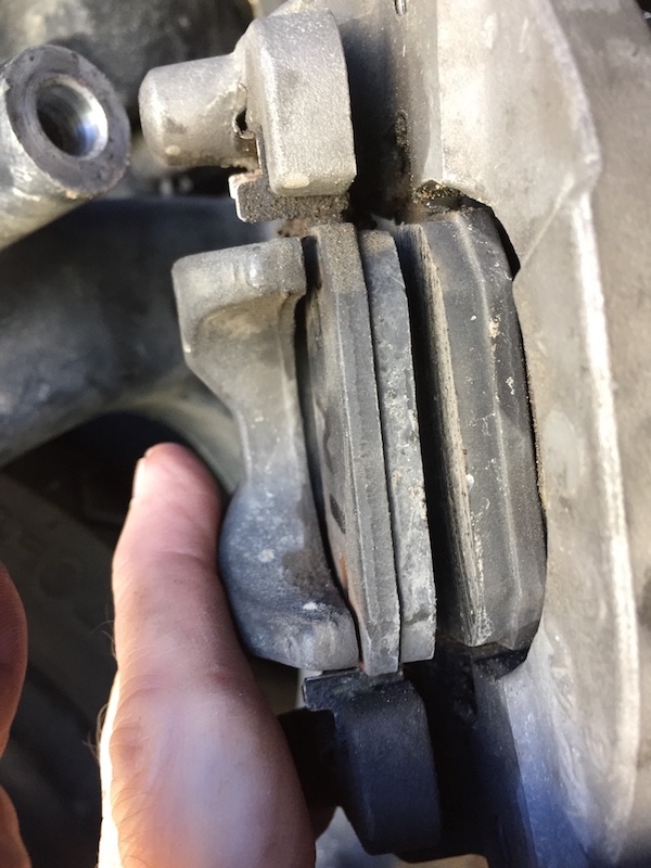

I pulled the caliper off today to have a good look. The brakes appear to be good after 2325 kilometers. I have 36500 km on the Forza now.
I think I accidentally got everything right. The Forza coasts a little better now and the acceleration seems faster. The top speed went from 130 to 140 kph.

Also while the tools were dirty it was time to look at the rear brakes once more. This set of rear pads has 4384 km and the fronts have 21513 km but still look really good. The rears are really good still. I think that caliper pin I replaced must have been bent. It spun strangely when I put it in my cordless drill.

Nov 13/16 I pulled the caliper again at 6300 km on the current rear set.
OK for now.

E. Foster Salsbury wrote:That sucks. Which one is the inside one?
The worn out one was the inside (piston side)
