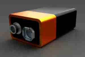

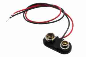

Mel46 wrote:Are you ready for my input on testing led lights yet?...I have installed about a dozen sets of led lights so far, so I know what I am doing, but each person chooses his own path. A STANDARD, OF THE SHELF 9 volt battery works fine. You don't need anything special. I made my own attachment for the connections. I went to Radio Shack and purchased a small bag of alligator clips. Then I measured two pieces of wire, one red and one black. I attached a set of clips to each side of each wire. Now I can use those wires with a 9 volt battery to test any circuit, including the standard circuits on the bike, aside from the headlight. It even works for holding the volt meter leads to each circuit. It should work fine for your needs.
Honkerman had it right.
You mean like one of these:
With one of these:
That's it?
Re: A couple of really odd questions...
Posted: Fri Jul 29, 2016 5:41 am
by GeorgeSK
Yup. It won't be at it's awesome brightest best, but it will light up and tell you which lead is positive.
Posted: Fri Jul 29, 2016 9:11 am
by Ishkabibble
GeorgeSK wrote:Yup. It won't be at it's awesome brightest best, but it will light up and tell you which lead is positive.
As my fantabulous Great-Grandmother used to say, "Well, the band will be playing 'who in the hell would have thought!'"
Unbelievable. I have to put that down to ignorance and a mental blind spot. Thank you.
However, there's this little voice nagging in the back of my head, "Ish... Wouldn't you want to see them lit up fully at all their awesome best glory?"
Another thought. I have an old automotive battery charger from the 1970s, and it has a three-way switch on it that says [2 - 10 - 50/jump]
If I put the selector on 10.... I have either a great chance of seeing yet another puff of magic smoke with the standard flash of light, or lighting up the LEDs.
Damn, I wish I knew more about electricity. I was never mathematically-oriented, and when I was a kid, I practically lived in the parlor of my parents' house. That was the room that had the encyclopedia and all the books.
Oh well... More to play with.
Thanks for the advice, gang... Keep it coming!

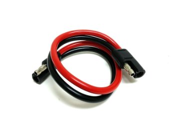

Do you use a Battery Tender? Is there a reason why you can't test the lights with the bike Battery? You don't have to take the battery out to use it. If you have a Battery Tender you may have the leads already attached to the battery. Use one of the extra leads you can purchase for $5 or less. Cut it in half. Strip the wires. Plug one lead into the Battery Tender wires. Now you can test the lights with the battery on the scooter and you can see what their brightness will be once you hook them up.
These are instructions for those who know nothing about electricity. I spent quite a few years as an aircraft electrician, and then I went back to college. I was getting a degree in electrical engineering when I had a motorcycle accident and had to drop out for a few semesters, which meant that I had to wait until the classes came back around on the schedule before I could go back...or change my major. I ended up with a degree in Computer Science. Sooo......I have electrical knowledge, but I also understand that there are quite a few out there who not only do not understand electricity, but are afraid of it. Therefore, I am trying to give answers that can help even those who are afraid that they will screw things up. Hopefully this thread will help others as well.

Here is a way to always know which is hot and which is ground...if the wires are red and black...I used this in aircraft electrical school to remember.
