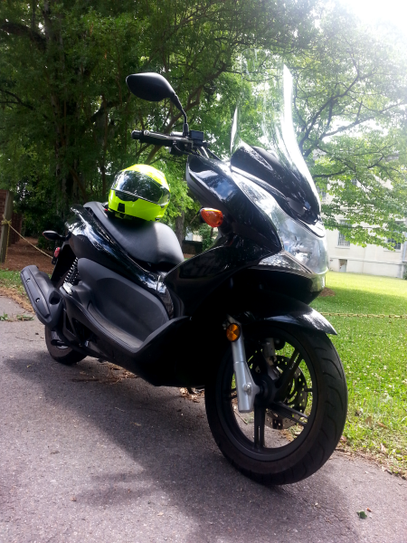

Well, as promised, I have a couple of photos to add showing the new windscreen on Natasha.
I also got the chance to ride about a little today, (about 45 minutes worth) and let me tell you, that windscreen makes a difference.
Here she is!

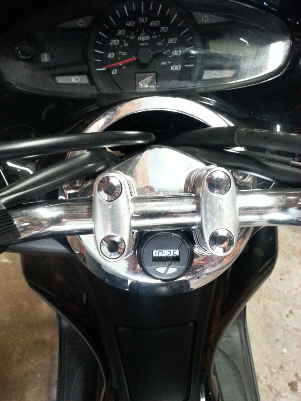

I got him out into the garage one day last week, and we were piddling around trying to decide where to mount an old light fixture, and I was explaining to him how I planned to repair the old dry-rotted termite-infested workbench that's 90 years old, and he asked what time it was. I wasn't wearing a watch, and thus didn't know. He pointed to Natasha and asked, "doesn't that thing have a clock on it?" When I told him she didn't, he just hummed a bit under his breath, and went on back into the house. Yesterday afternoon, he came out to the garage where I was putting away some yard tools, and handed me this little paper bag. Inside, was that neat little digital clock. Dad just smiled, and went on back into the house. I hope that when I get to be 85, I have that kind of sense of humor.

That's Terrific Ish! A keeper ticktock! Forget the clock I mentioned. Your's is Special. Love the memory you two just made. My Mom will be turning 91...I can relate. She surprises me All the time with ideas and resolves.

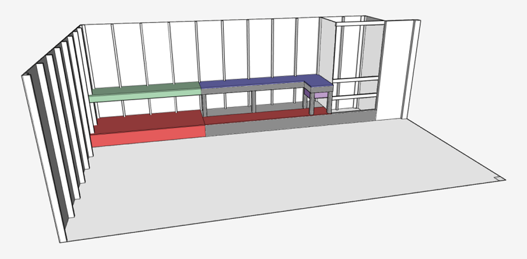

The last I left it was that I had stripped all the dry-rotted, termite-eaten planking from the top of the workbench. The basic foundation to the bench is good, except for a couple of pieces that are going to be fairly easy to replace. I'm also planning an extension to the bench, to carry it all the way along the wall of the shop platform along the side of the garage, to create a place for my vacuum-former and soldering station. I drew up a diagram of what was there, and what needs to be done, so for reference purposes, here it is:
For reference, the gray area is what was existing before I started this. The blue area is the bench top that will have to be replaced. The red area is the new flooring I've already put in, and the green area is the new bench area I am going to build.

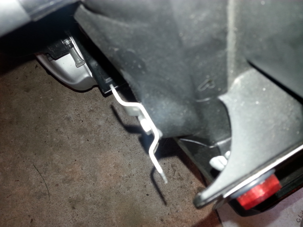

Here is an update to the Transfiguration...
Let me first say that getting the aft body panels off was hell the ruggedest mile. Getting them back on was an even bigger PITA, even though I used Maddiedog's excellent tutorial, and even the Service Manual. Utterly and totally exhausting.
As many of you know, it was my intention to add a bit more lighting to Natasha for visibility and safety reasons. As the semester wears on, I know I'm going to be coming home from my evening class in the dark, and wanted to have a bit more light on so that I'd be more visible on the five-lane road I travel.
I went through an evolution to adapt the LED running lights because they had two mounting holes on either end, rather than one central mounting bolt, so putting them in the place of the existing reflectors wasn't possible without some modification. So I designed up some brackets, fabricated them from aluminium strips, and they worked exactly as I had envisioned. You can see those brackets here: http://hondapcx.org/viewtopic.php?f=7&t=6519#p89913
Yesterday, I decided to bite the bullet and I mounted the two rear running lights. I must say they turned out even better than I expected, and man, those things are BRIGHT.
I also added a pair of 3" long red 3528 LED strips into the rear reflector that Mel sent (Thank you, Mel!) and wow, it really adds a good bit of light to that reflector. Much brighter than the $3 reflector/lights you can get off Ebay. (Yes, I got one, and was totally underwhelmed at the amount of light it puts out.)
So, here are some photos. I have only done the rear running lights, as I want to wait on the Posi-Tap connectors I ordered, so I don't have to cut any of the wiring up front. In the back, it wasn't so much an issue, as I used the license plate light as my power/ground. Oh, and I also took out that little T-10 bulb, and replaced it with a pair of 2" long strips of 3528 LED lights.
I hope everyone else likes the end result as much as I do.
The amazing part of this is, the damn things work!
Once my Posi-Taps come in, the front will be next. I also have a pair of strip-Daytime Running Lights coming, and I'll install them at the same time.
After that, we go to the LED turnsignals... Wow.

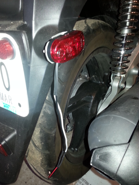

- This is what the new brackets look like when mounted to the running lights.
- 161221.png (208.55 KiB) Viewed 3865 times
- Here's the bracket mounted to the rear location where the round reflector originally was.
- 180222.png (339.28 KiB) Viewed 3865 times
- Here's the running light mounted to the bracket on Natasha, before the wiring was completed. I had to add some length to the wiring to give me more to work with.
- 180201.png (373.16 KiB) Viewed 3865 times

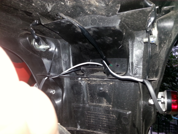

- Here's how I ran the wires under the rear fender. I found some 5" long zip ties in the Lair, and used them to secure the wiring.
- 182447.png (368.88 KiB) Viewed 3865 times

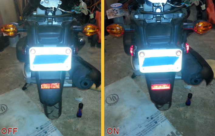

- Here's the running lights installed, in a split-image to show what they look like both on and off. I had all the lights on in the lair, the overhead, and two additional floodlights, so they don't look very bright. In retrospect, I should have covered the plate completely so it wouldn't reflect so much of the flash.
- 200450.png (450.6 KiB) Viewed 3865 times
