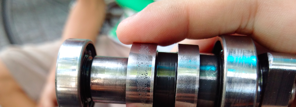

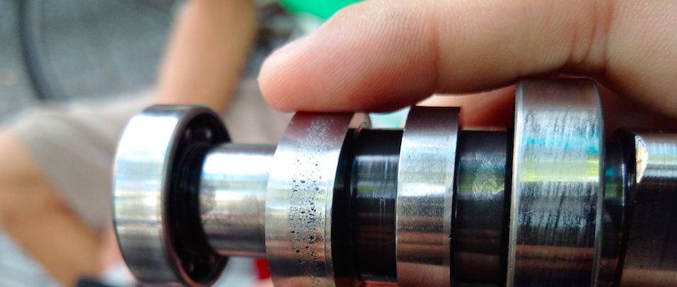

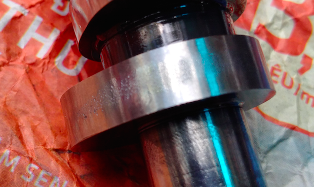

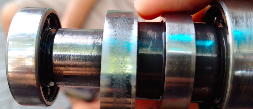

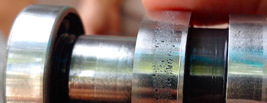

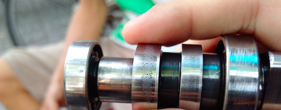

I put out the Yuminashi cam btw, this guy has it too but it has some holes on the surface, does not look too good, I'll see if a stock cam can work well with this setup. I'll have my new 125 head, valves and stock cam next week with the wire looms.
I'll be sure to take pictures.

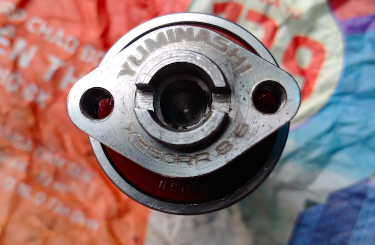

However, I mentioned directly to Reggy that I intend to use the stock camshaft he still recommends 0.05mm IN and 0.08mm EX, even for a stock cam and he insists that more clearance would cause some tickling. When my scooter is full stock, I don't notice anything so maybe my mech who wants to go stock valve clearance is right, guess I'll have to disagree with Reggy, but if anything's wrong, my mech can change the valve clearance in about 20 minutes, give or take. Anyway, do the valve clearances have anything to do with a valve spring hardness? I'm putting in Sonic springs so I'm a little curious.

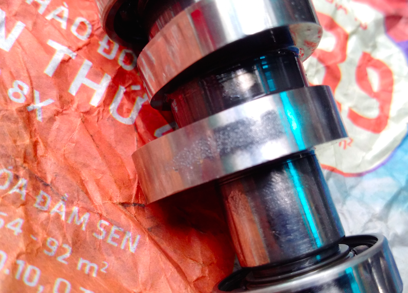

Here are the pictures of the Yuminashi camshaft, it's the RR version, I'm not accusing anything here, just posting pictures. Remember, Reggy himself agreed to replace it right after seeing the pictures so they are just for reference. Dealing with Yuminashi has been one of the most pleasant and informative experience for me and my friends. Can you check your camshaft surface Vlad for anything that resembles these?

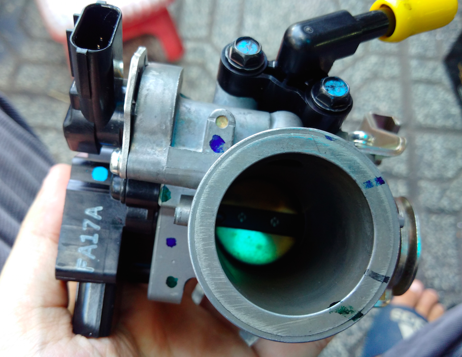

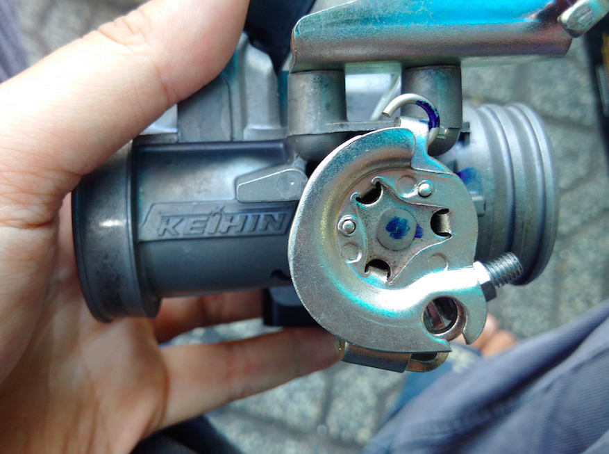

This is a CBR150 throttle body. I guess Yuminashi just got them from Keihin and done some work with polishing the throttle body intake, I guess you get what you paid for. They did a fantastic job polishing it. Just throwing it out there, if you manage to get your hands on a spare CBR150 2014 throttle body, you can save yourself a little money, but if you do decide to buy a new one, it's better to just get it directly from Yuminashi since the price for the throttle body alone bought from honda is about the same as the mirror shine polished one from Yuminashi, you still have to buy the A type manifold, if you have a PCX 125 1st gen or you can order the manifold from Honda and bore it up a little then it's fine, but you'll still have to buy some rubber connecting things from Yuminashi.
