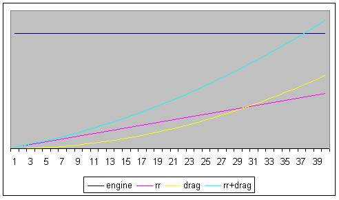

j.d.b. wrote:
Eiron wrote:My 2015 seems to get the best fuel economy between 30-35 mph.
This---^
Generally speaking the best economy will be had at the fastest speed before invoking air resistance. On a calm day, on level ground, 30-35(mph) is about the best.
Actually depending on the rolling resistance and drag coefficient of the given vehicle the rolling resistance and drag equals around 100km/h or 60Mph. Below this speed rolling resistance is larger, but scaling linearly with speed. Above this speed drag is the higher force and actually scaling exponentially.
Go figure why the selected speed limit around the world for off highway traffic is below this speed, usually around 90 km/h or 45-50Mph.
For those who are more technically inclined and would like to have better explanation:
vehicle forces.jpg (18.47 KiB) Viewed 4651 times
X-axis velocity in meters per second and forces are in Newtons on the Y-axis.
The traction force (dark blue) is an arbitrary value, it does not depend on the vehicle velocity like an ideal CVT scooter transmission keeping RPM and power constant. The rolling resistance (purple line) is a linear function of velocity and the drag (yellow curve) is a quadratic function of velocity. At low speed the rolling resistance exceeds the drag. On this chart at 30 m/s (108km/h) these two functions cross. At higher speeds the drag is the larger resistance force. The sum of the two resistance forces is shown as a light blue curve. At 37 m/s this curve crosses the horizontal traction force line. This is the top speed for this particular value of the engine power (37 m/s = 133 km/h = 83 mph)

This is where real life and that "assuming RPM is relatively constant" is making a HUGE difference.

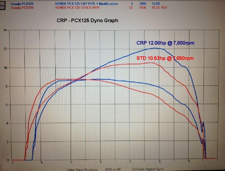

Peak power does not tell much about the operation of an engine, however a dyno chart speaks quite a bit more. Effectively it is a graph of engine efficiency. To explain better, I will use a dyno graph taken from an earlier topic where a stock and performance exhaust had been compared real life on a dyno.
pcx performance.jpg (64.62 KiB) Viewed 4646 times
It shows power curves (wheel Hp seemingly) for the stock and modified engine, but we will take a look only at the stock as for now.
As you can see peak power (and peak efficiency also, as power is not increasing further even by increasing engine RPM) happens at 7650 RPM peaking at roughly 10.5 whp. Anything beyond that point is downwards getting to 6whp @9500 this is down by 37% in efficiency at WOT. Giving the additional ~13% loss in fuel economy from A/F mixture change (the diffrence between 14.7 and 13.2 AFR) might explain why you see a significant drop in fuel economy.

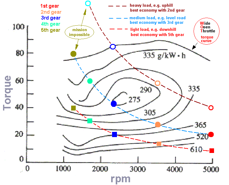

There is however a great tool which is created to represent economy values. It is called a BSFC map. (Brake Specific Fuel Consumption) This supports the above statement, that top fuel efficiency happens near at top maximum torque as this is the point where the engine produces the most power compared to its internal losses.
The following graph is showing a typical street car engine specific fuel consumption at WOT (continuously accelerating at open throttle as an a dyno.
Plotting every operating point of an engine on a map can give us engine specific parameters, with engine RPM and load on the two axis and the "islands" representing fuel consumption. the map below shows a BSFC map for an another engine, including gearing.
One can see that there is a "sweet spot" of RPM vs load on the engine where specific fuel consumption will be the smallest - in this case 275g/kWh. Moving the operation out of this area either by load (eg. a steep uphill) or RPM (gearing) will result in significantly lower economy.
