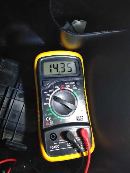

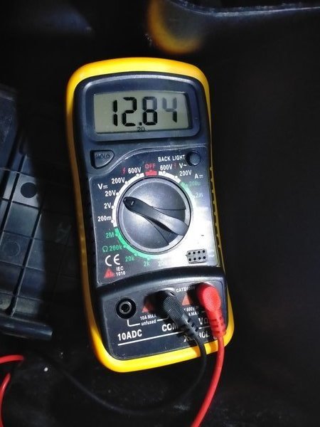

Checked the battery to make sure it's really shot before I buy a new one.
Results:
Standing charge
Didn't go below 10V upon cranking and
idling voltage is fine
Methinks the battery is fine. Or do I also need to check the Amperage? Although Im not sure how to properly do that.

Althought this fault could be many things, battery volts alone do not mean idle stop will work properly - the ECU has a staggered graph it works to and if it believes the battery is not up to the task, idle stop is disabled. Honestly, no idea why people bother with it for the very small savings.
