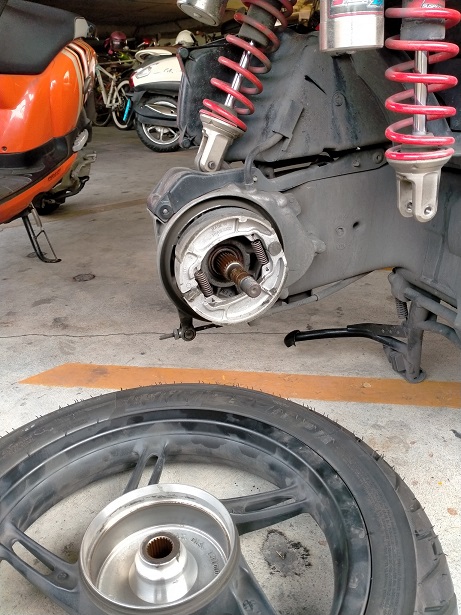

I want to revive this thread because I'm trying to find ways to improve the rear drum brake. The brake doesn't feel progressive, it'll feel weak but if you squeeze a little bit then suddenly it'll seem to lock the brake immediately. I want to be able to modulate the braking feel but the rear brake seem to only go from weak to a sudden lock, no in between. My PCX isn't like this when new, it's just something Iv'e noticed recently. So is there anything I should try doing first? change Brake lines? try Aftermarket shoes? also, Iv'e done changing to new shoes and cleaning the brakes but it doesn't seem to improve anything. Front brake works perfectly though.
PS:I'm not sure if you guys get the same feeling or even know what I mean. LOL

I did open and cleaned the drum brake again yesterday, put grease on the brake arm and stretched the spring on the arm again; and it seem to have alleviate the problem somehow. I'll let everyone know if anything is conclusive after some time.

seriously though, cleaning the drum, lubing the brake arm and using some good quality shoes seem to have improved the rear brake's feel.
although, it still left a lot to be desired. probably just gonna accept the fact that drum brakes are like these.
an adv 150 looks interesting with its disc brakes and abs, and so is the nmax..
converting to rear disc is out of the question, it's just not worth it..imo
