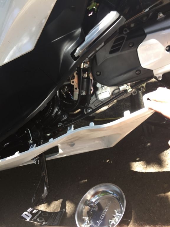

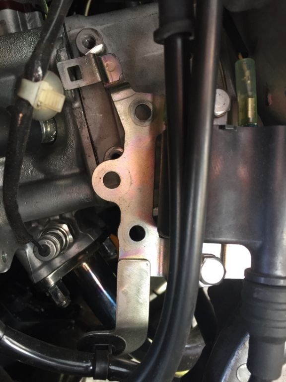

In other news, while I was working on the trans, I noticed a part dangling off of the engine:
I believe that's a clamp for the throttle cable.
It's funny, my brother knows the co-owner of the scooter shop who did the 175cc BBK install. She sent him a pretty pissed off text because I noted a screw was missing from a fairing panel near the seat, stating that "he makes it sound like it's our fault". I certainly didn't screw with it, and I didn't ask anyone else to either. And my concern has more to do with missing a vital bolt or screw that holds the engine together, as I didn't want to blow up while riding on it.
I would say that concern is very well justified, as only one shop ever touched the engine on the PCX, and I doubt the bolts just upped and walked away on their own.
