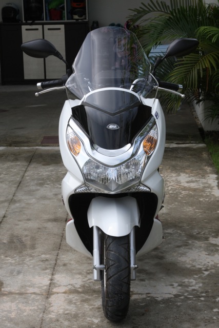

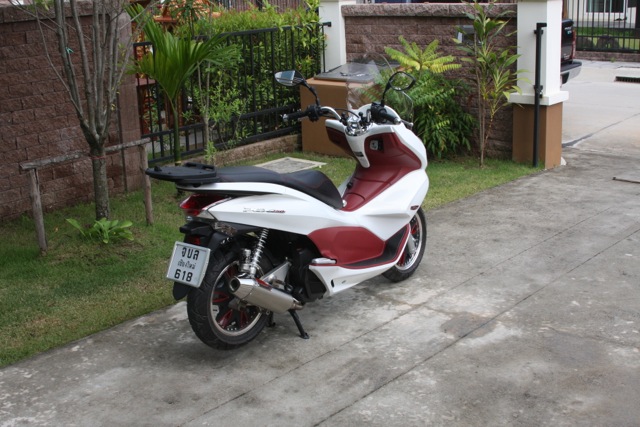

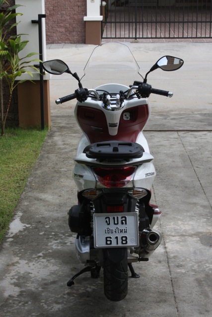

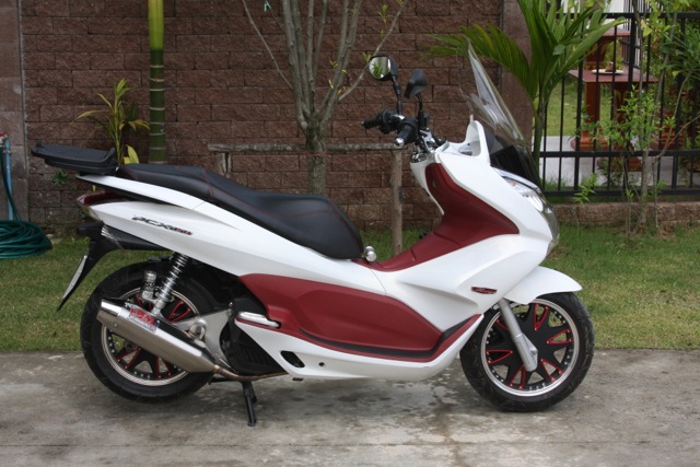

A few more changes have been made, here are the latest updates and comments about each.
YSS Shocks - I decided to change the stock shocks out for a set of the YSS Shocks because I kept bottoming out of a couple of large speed bumps in our housing development and got concerned about the long term damage it could cause. Also, on trips when loaded with the GIVI topbox and other gear the stock shocks were doing overtime. The model I used had the (XXL) rating which is better suited for normal sized individuals like myself. I'm pleased with the results, no problems with the speed bumps and I'm slowly adjusting the settings to get a little less stiffness. Cost was 3900 THB plus 150 THB to install at the local Honda dealer, this converts to about $130 USD.
GIVI Windscreen - I think this is one of the best improvements I have made so far. Being taller (6'4"+) than most riders the addition of this screen provided me a bit of an aerodynamic improvement. I still get the wind in my face and have helmet noise like everyone but I had all that before as well. The PCX seems to get going quicker that it did with the stock screen. Cost was 3300 THB plus 300 THB for shipping, this converts to about $120 USD.
Exhaust - Here in Thailand just about anything can be made or crafted if you find the right place. I had been looking at all the cycle shops and they all had the same models on display and there were slight differences in the design, outlet shape, direction, finish and mounting system. The basic models were going for about $ 200-300 USD. I found a local shop who does fabrication work and we struck a deal, a custom stainless exhaust for 3500 THB or about $116 USD. So I now have a new exhaust on the PCX. It is shiny, has a nice sound and yes if can be loud at times. Does it help with the performance, not sure but I did run the bike up to 110 (based on the Speedo) with more left. I'm thinking the GIVI windscreen probably provided more improvement than the new exhaust. I kinda feel I will swap back to the factory exhaust at some point, I'm sure the rumble will get louder with time and it will get on my nerves.
Here's the latest pictures.

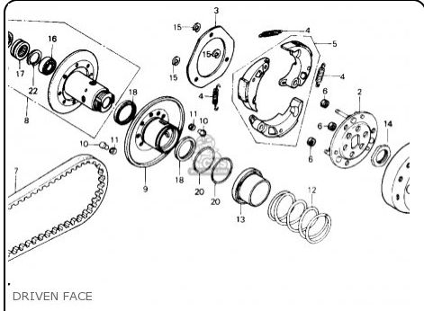

Just a couple of updates. I'm nearing 12,000 km on my PCX and I have noticed a couple of performance/maintenance issues as time goes on. Just wanted to check and see if anyone has noticed the same or had similar problems.
1. I had a noise coming from the rear end of the bike. Most noticeable when rolling the bike around the garage or parking area. It sounded like a grinding noise of some sort. I took it by my Honda dealer for a test drive and they determined the bearings at the rear wheel needed to replaced. The 2 bearings on the right rear were replaced and this resolved the grinding sound I had been hearing. This was not covered under warranty and the total cost for replacement was 487.00 Thai Baht and a couple of hours for the repair. The 2 bearing replaced were numbers 16 & 17 in the parts breakout below. Not sure why the bearings failed so soon but my driving style is mostly dry normal conditions and I have only ridden in rain a few times (no rivers crossed or off-roading) and all maintenance was done as suggested by Honda. Maybe the problem was a result of having the aftermarket tires and wheels installed and the tech who installed this got something not just right?
Luckily the cost and fix was reasonable.
2. Under steady acceleration from 0-80kph, I have a noticeable change in acceleration rate when I hit 65 and then it picks up back at 75 like normal. The engine is not missing or starved for fuel. It feels like the drive belt, variator pulley or weights in the drive system are beginning to wear and producing this symptom. Like I mentioned, it only happens between 65-75 kph and is only a small decrease or sluggish drop is acceleration.
Has anyone experienced anything like this? Did you replace the anything or make any adjustments to fix this issue?
Screen Shot 2013-01-27 at 11.57.29 AM.jpg (35.01 KiB) Viewed 5359 times
Re: My PCX150-White/Red
I'd replace the belt and clean the pulley surfaces as a precaution and before doing anything else

GN2 - he made a reasonable request, and is right -- things are different in the UK than elsewhere. Honda USA will validate warranty claims, even with minor modifications. They replaced my engine block under warranty because the centerstand broke, despite me basically replacing the entire back end, hacking out the passenger handle, and adding a rear rack. I doubt he has any intentions of reading his warranty.
At 12k km, your rollers might be worn. If you have an impact wrench, it's pretty easy to remove the variator to check. Alternatively, you could just have the shop do it for you. I'm jealous of how cheap everything is over in Thailand, even having my variator troubleshooted for an issue like this would be easily $100. :lol:
