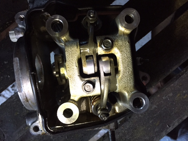

Which parts are the cams? And what do you mean by it doesn't look like it has been burning oil?

2 seized 125s recently, so I got a bit mixed up with the previous post. You don't make clear if you checked the oil after the seizure, was it low?.
The cams are on top of the cylinder head and are what pushes the valves down. Any scouring on the lobes (the point that pushes the valve down.

The spark plug definitely doesn't look like that picture! Most of the components look to be in pretty good shape. I've attached a picture of what I think are the cams - these don't appear to have any scouring marks on them at all so they're all good.

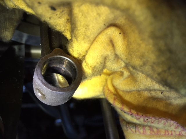

Getting the piston off the rod took a lot of force, far more than I think it should have, but the rod itself looks okay. I've attached a picture of where the piston ring goes into the eye of the rod. It looks like there's a groove in the eye of the rod, does anyone know if this is normal? I popped into the local Honda dealership today and the guy there said if the piston wasn't turning freely on the rod then I would have to replace the rod and whole bottom end part (crankshaft?) which would mean completely taking the engine apart - he also said the part to replace this would be £325! Given that the rod seems to be in fine condition, I was planning on just buying a new piston and ring and seeing if the ring would fit in as it should and if so, getting the cylinder rebored. It not, then I'll probably look into selling it.

Ooh can't tell for sure but that might be a plain white metal bearing. When the gudgeon pin came out was there an obvious roller or ball bearing in the centre?
If not doesn't look to good, seems like there is a fair bit if scoring on the soft metal surface

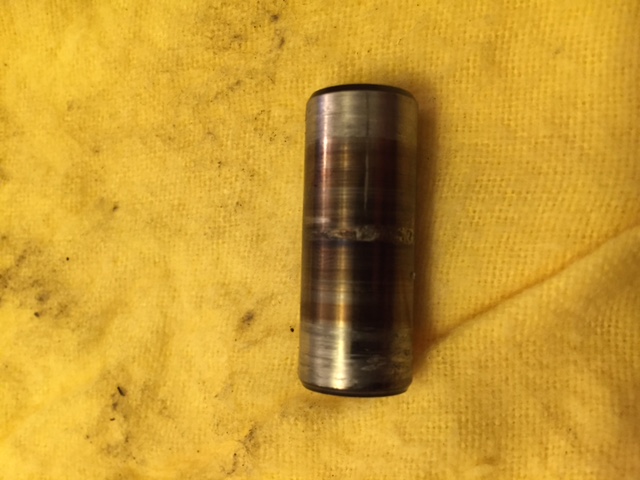

I can't see any bearing on the rod itself nor on the pin. The pin is scored about 3/4 of the way around - I've attached a picture of it. It looks like it was part of the damage from the seizure.
Apologies if it's a naive question, but would the scoring in the middle of the eye of the rod have much of an impact on the running of the engine if I replaced the piston and fixed cylinder and if so, how?

Always awkward with pictures and others will have their opinions but I would have written off the piston, rings, pin and rod by now. Mains and big ends may be OK but might be worth checking
You might be able to get the rod bearing surface remetalled

You're right, the piston, rings and pin will definitely be replaced, but if it's just the eye of the connecting rod that is scored slightly, I'd rather try to fix that as it is. I'll take a look at the big end, but it seems as though you can't see much without taking the whole bottom end apart.
Re: Seized Engine
The big end isn't repairable, the crank, bottom end bearing and conrod are only supplied as a single unit.

And if the wrist pin is that badly damaged, the bottom end has seen better days. You don't want to go through all of this and have the bottom end get noisy in 1,000km. Did you look under the cam at the bearings? That is undoubtedly shot so you need a head. Might as well get an aftermarket big bore/ stroke kit with the bigger head and cam and injector. And then you will also need a fuel computer and a mixture logger so you can tune it. Now you are headed for the far side of $1,700/ 1,100 pound.
