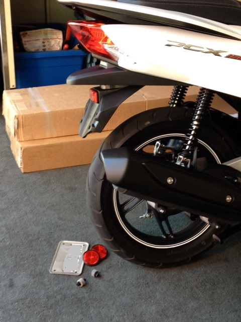

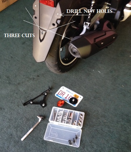

This worked out nicely... special thanks to dem0nk1d for the guts to just go for it!
No thanks to WARFAB who is slower than Moses
Tools needed;
10mm socket, hack saw, 1/4" drill bit, razor or knife, propane torch (optional)
Tools needed;

The propane torch if used carefully will give a finished look to the rough cut edge after you clean it up with a razor and sand paper. Practice on the scrap piece using a parallel angle to the flame never letting it actually get hot and you will see what I mean
You should set aside a couple hours for the whole process... ENJOY!

My fender chop...very similar to the one above, tucking the plate right up next to the reflector and used wood screws with a dab of goo on the back of the screw to keep if from backing out should it ever try to. Did not run the side reflectors like the post above. 11.1oz removed (almost 3/4 lb).
First pic you can see where I drilled the holes on both sides just below the reflector for the license plate.

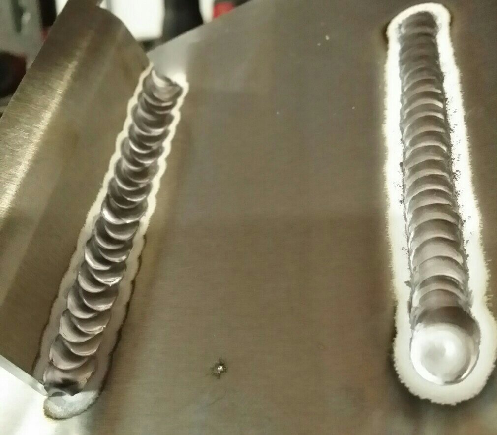

Gonna weld a few up right now

Having some fun with these welds

HEY! WARFAB took a day off work, last post September 22nd
Nice weld, I know how hard it is to run a bead like that on aluminum without a tig welder (tunston inert gas) you make it look professional.

lol my profession is welding [WINKING FACE]
Yeah mine has a noise too I think it's coming from the valve train I need to check my valve lash
You kind of need a tig to weld aluminum like this
