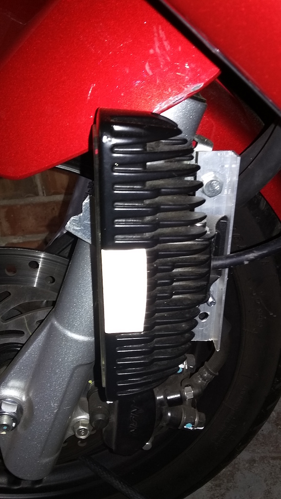

Now that I have had the LED lights on my bike for quite awhile now, I love where they are situated and the fact that I hooked them up directly. I solved the problem of people accidentally turning them on by drilling a very small hole all the way through the switch and inserting a safety pin through it.
The lights themselves are mounted where the side reflectors were by the front wheel. There are two ways to mount them.
The first is to get long bolts with multiple locking nuts to run through the holes where the reflectors had been, after removing the reflectors and their holders. One locking nut would lock the bolt against the fender anchor point that the reflectors used. Another locking nut would be used on each side of the new light, where the bolt went through it. You can adjust and tighten as necessary to adjust its position.
The second way, which is what I did, is to build an adjustable platform. I can't really explain that to you because it has an adjustable swing arm that I had to think about before creating.
Here is a picture of one of them installed.
