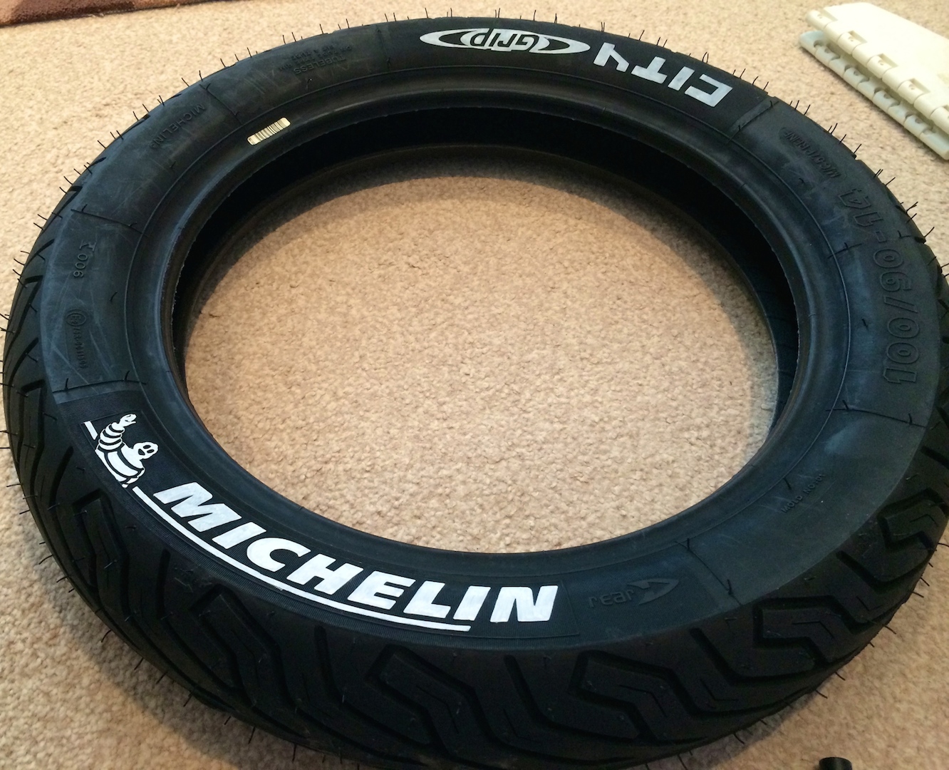

Got the Tyre today :-) thanks for the hook up gn2
just got to get it fitted now, should be fun taking the parts off!
Oh and maddiedog I made a separate thread about the Pads,
apparently they're still ok, abit weird about the rear Tyre needing replacing though.

No, I got Paint Markers, was bored so coloured them in on both sides, will do the front one on the Bike when it isn't raining, think it looks better like that.
