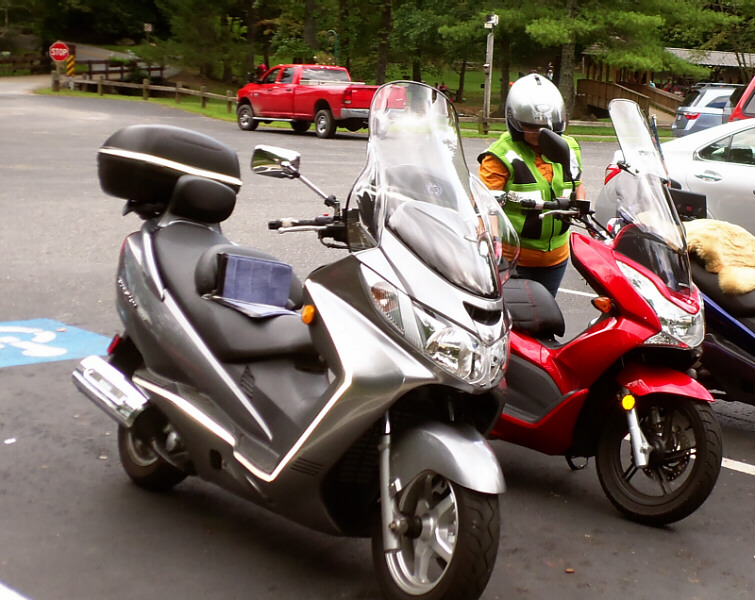

Dave, I MAY have a solution for your windscreen problem. Note that I said MAY. You will have to look at our windscreen to see if the concept might help you keep the wind protection but lose some of the wind resistance. We have ordered one of the tall windscreens like you have, but we are not going to get rid of the one I modified, just in case the larger one doesn't work out. Here is a picture of our bikes when we stopped a Vogel Park recently. Look at her windscreen. The upper part is narrow but still provides protection. I added that mod. It has been on her bike for long enough to know that it can withstand windy days and freeway speeds. It is just a thought, but it might work as a compromise.
Us at Volgel Park.JPG (162.46 KiB) Viewed 8160 times

Mel46 wrote:Dave, I MAY have a solution for your windscreen problem. Note that I said MAY. You will have to look at our windscreen to see if the concept might help you keep the wind protection but lose some of the wind resistance. We have ordered one of the tall windscreens like you have, but we are not going to get rid of the one I modified, just in case the larger one doesn't work out. Here is a picture of our bikes when we stopped a Vogel Park recently. Look at her windscreen. The upper part is narrow but still provides protection. I added that mod. It has been on her bike for long enough to know that it can withstand windy days and freeway speeds. It is just a thought, but it might work as a compromise.
The screens have certainly kept the bugs and dirt away
That's kinda cool, it's like the laminar lip windscreens. I don't consider my windshield a problem though, but I'm still interested if what you've done offers better protection than my setup.
