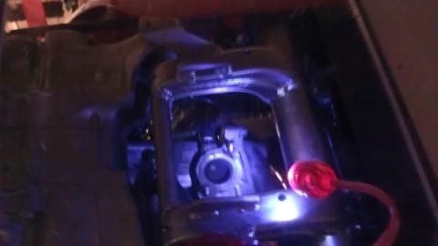

Just to let everyone know, I decided to go ahead and tear down my bike in preparation for Dave and I putting the same type shocks on my bike. Thanks to this How-to I have been able to fully tear down my bike and install the new shocks without having to inconvenience Dave. I have all of the equipment I need in my semi- finished basement. I even have an I-beam (actually 2 I-beams hold the house up) in the basement that I used with a ratchet strap to take the weight off of the shocks. Dave made that recommendation. It worked quite well. Luckily, every time I had a question that was not discussed in the How-to, I would call Dave and he would walk me through it. The only real question I had was what the size of the exhaust bolts were that were connected to the block, since they are chromed and had rounded tops. I finally got a large mirror and a small clip on book light to actually see what was up there. (Its a 10 mm with a long head on it. Strange looking.) So once again, thank you Dave for all of your help and your GREAT How-to!!

Hopefully everyone can see this picture. This is what the exhaust area at the block looks like after the exhaust is removed. It is not easy to reattach the exhaust though. I had to have my wife block the front tire, weigh down the handlebar area with some tools, and use ratchet straps to raise the bike high enough for me to actually see up into the area where the exhaust connects to the engine. Then I had to use my knees to raise the muffler enough to align it. What a pain! It worked though. That is all that matters.

Mel46 wrote:Hopefully everyone can see this picture. This is what the exhaust area at the block looks like after the exhaust is removed. It is not easy to reattach the exhaust though. I had to have my wife block the front tire, weigh down the handlebar area with some tools, and use ratchet straps to raise the bike high enough for me to actually see up into the area where the exhaust connects to the engine. Then I had to use my knees to raise the muffler enough to align it. What a pain! It worked though. That is all that matters.
I didn't have this problem. Couple of nuts onto the head and thee bolts to the "swinging arm". 2 minute job.
Have I missed something?
Re: How-To: Swap the Rear Suspension
Posted: Fri Aug 15, 2014 12:18 pm
The 3 bolts were not the problem. That was easy. However, I had to actually see where to insert the exhaust into the block bolts. Without actually seeing where to insert it, trying toget it aligned correctly was difficult. I would get one in and find that the other was beside its bolt. Then I would have to start all over. When I finally was able to finally look at it while inserting it, I had no problems at all. Definitely a 2 minute job then. There is probably a secret to doing this easier, but I don't do this often enough to learn about it.
