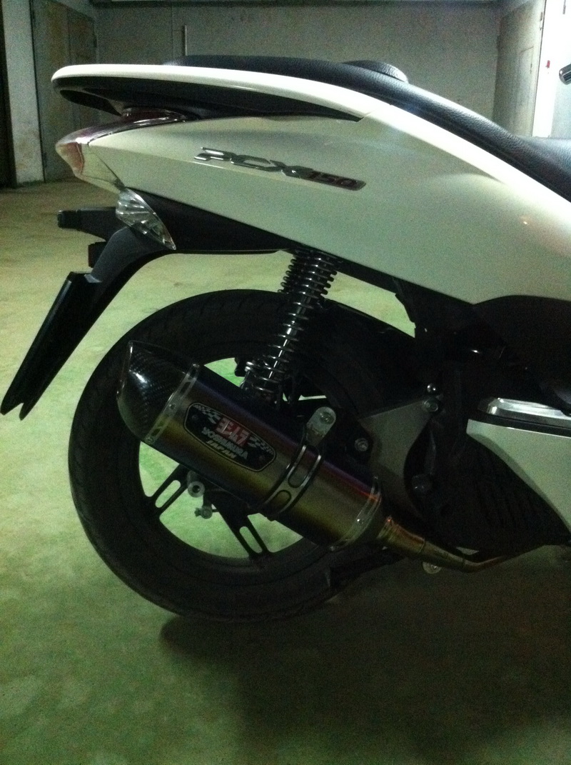

Hello, pcx people!
I just received and immediately installed the Yoshimura R77S titanium blue exhaust. Yes, it is an expensive thing, but I should say it worth it. The sound is not too loud, but with a very low frequency and aggresive sporty tone without ANY annoying rattles. The look of it is fantastic, high quality made thing. First test ride showed some noticable power gain in the high-rpm area, the acceleration from 80kmh (50mph) became better, and for the first time I saw 116kmh(73mph) on my usual way home, without pushing throttle that much and waiting the numbers to grow, I just drove like I did every time, and bike ran faster! On the low and mid rpm seems no any difference, just the low bass sound.
Overall, I can say that yoshimura do it's job, and the graphs they show on a website are true, the power gain exists and noticable, but only at the top rpm area. And emotionally I felt happiness like a boy, now my pcx is kinda sporty thing!
- IMG_24871.jpg (307.04 KiB) Viewed 6391 times
Re: leo vince exhaust
looks like they kept a farely small header compared to the leo and if i could drop 500 on a pipe i would

Earlier days I changed some exhaust manifolds on my N/A sporty car, Honda S2000, and I can say that the design of them is critical to the power curve. Some of them work only at high RPM and drop the low and mid zone, some like "torque kun" just rise the mids, the pipe lenght, the pipe diameter, and form-factor (4-2-1, 4-1) are very important. This yoshi makes improvements at high rpms zone without crushing lows and mids. Actually If you look inside of a yoshi piping, it is quite thin diameter , just same like the OE one.
The price is high, I was thinking to buy it or not for a week!
But if you buy any other brand exhaust and you really want to do it, the difference between them is not that much. So why not to buy the best looking, best sounding one? Now it is a treasure on my pcx and I am very happy even when I see it! One more time, the sound of it is great, yesterday evening I visited the biker's meet. My pcx was standing on the center stand and the vibrations from yoshimura came thru the ground very far. Some of old bikers came to me to see what happens and what is producing this earthquake, that was my yoshimura!
