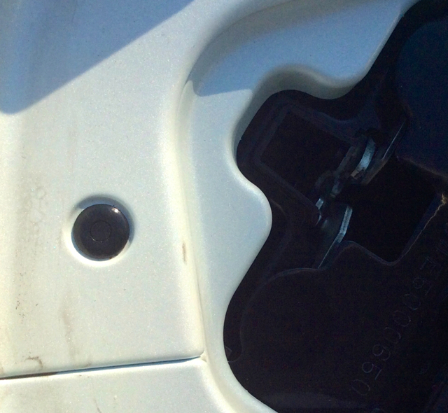

Wanted to unscrew the plate and see what is underneath, but I'm stumped by the type bolt/screw used. Any advice?BrAtKo wrote:Any news regarding to this ?ChesneyHawkes wrote:I'll unscrew the back plate and see if they have pre-drilled holes.iceman wrote:Be great if the new 2014 125 PCX has the guide holes ready made for a top-box.

It looks to me like it is a plastic snap with the center section somehow popping up to allow the outer part to pull out of the hole. I have no idea how to lift that center section out though. It may well be a one time use snap, so be careful before you decide to try to remove it. You might want to stop in at a dealer and ask.

Re: New White PCX 150
That is a reusable push pin. Push the center down, then use a small screw driver to lift it out at the edge. Once out the center can be pushed back up. It can be a little tricky. Install the pin and push the center down to be flush as it was when you started.
Don't try to pull it out. Push it in, it is the same like at the battery cover of the 2013. After you push the middle in about 5 mm you can pull the beast out. To remount, push back the center, insert the plug and push the center in until it is even. The procedure is described in the manual.iceman wrote:Not sure if the middle bit pulls out, otherwise looks like a rivet.

I have those all over my Burgman 400. Here is a link to where I get replacement clips. A lot of motorcycles and scooters are using those now because they are cheap to replace. http://www.boltmotorcyclehardware.com/p ... ivets.html

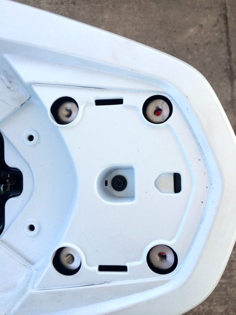

Good job everyone. Used the phillips screwdriver in the toolkit to puncture the middle bit, a bit of wiggling with the plastic plate and voila!
Do you think I can attach a generic mount? I've never had a top box so any advice would be great.
That looks exactly like what you would need to put on the generic mount. You will probably need to drill out the piece that you removed so that the holes in it are large enough.ChesneyHawkes wrote:Do you think I can attach a generic mount?
I used the generic mount because, in my opinion, it looks less bulky than having the Honda one along with the GIVI one, which makes it look like it has two mounting plates.
As well, if you put on a box that has a brake light, you will likely need to remove the plastic piece that is still there so that you can access the brake light wiring. I have the wiring instructions to hook up a GIVI box, but what I would be uncertain about is if the 2014 model kept the same wire colours as the previous models. That could be determined by a simple visual check. It is really quite simple. Just let me know if you want it.
[/quote]
I don't think I need to drill the plate that I removed, it just covers the holes, nothing else. I'm sure the mount would obscure the whole plate area. The way it's grooved, there may be specific mount available from Honda. I think a tighter interlocking fit would be much sturdier and allow more weight on the back.
6ftMach1Girl wrote:So now I'm very curious - would that piece fit on a 2013 model, so I wouldn't have to drill holes?
The rear of the 2014 is very different to the 2013, it exposes the who area for the top box in a rectangular shape so I just remove the cover plate. The 2013 has no cover plate and you have to actually drill the body work.

Not an issue for me as I have the 2014 model with removable cover, doesn't need holes to be drilled.
chesney every cover if you mean tail bodywork panel is removable
but on previous models, on removed panel the drilling of holes was needed. How it is on your new model is not so clear for me. Do you need only remove black plastic bolts to open the holes ? After removing how the body panel holds on its place ? Does it mean I cannot use this top case plate 08L70-KZY-910 ? Thanks. P.S. My new PCX should be available 16th april here than I prepare for.
