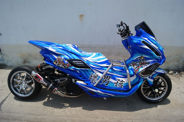

Re: Stretched engine mount
Wouldn't work in Bangkok where every inch counts when maneuvering between cars. Stretching it out would increase the turn radius. But I do think it looks kind of cool, especially if you stretch it like this.
- Thai Bikes 001b.jpg (70.39 KiB) Viewed 5037 times
- Thai Bikes 001a.jpg (68.09 KiB) Viewed 5037 times
