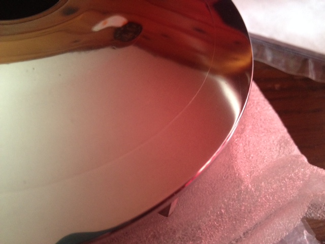

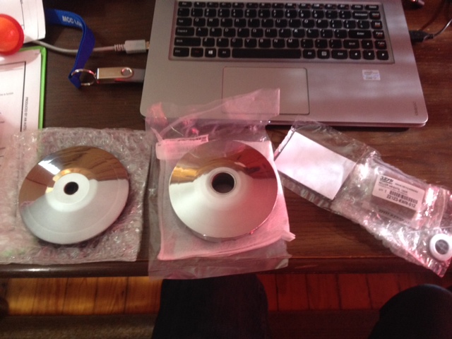

Yes, that is the variator. You won't see any angles in that picture. Here are pics of the Yuminashi kit as I received mine. The ramps are rough in the upper areas to slow the rollers according to Reggy at Yuminashi and from experiance I would suggest the use of Malossi clutch springs with this variator because takeoff is not strong below 15mph and there is a slight vibration. With the clutch springs this is eliminated. Also if you can stomach it get the Yuminashi contra spring too. These together with the variator will give great acceleration.

There are five angles on the pulleys. For sure three if not four of these are actually used by the belt.
