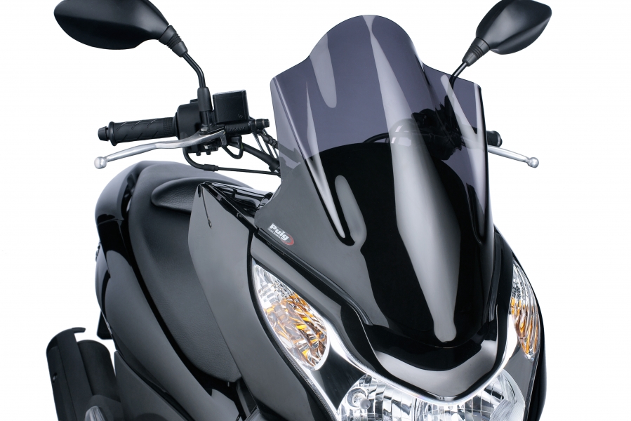

Also on my wish list is the Puig windshield that appears to reduce drag.

On another topic, remember that the larger the windscreen the more air you must displace which devotes power to displacing air instead of top speed. Personal opinion... If you want to go over 70 mph stick with a givi 322.
That being said, I should have my yuminashi variator next week and will be testing it with my large biondi screen. We'll see how that goes.

The "savings" could go towards a windshield.
I find the force on my chest quite extreme when riding over 100kph.
I can only really go on what others have said but the Puig looks quite streamline to me...
