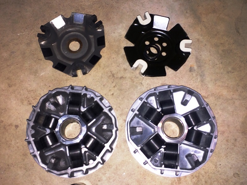

Re: Gears for higher top speed
heres an example of an aftermarket variator that has full length ramps
- ncy variator.jpg (7.2 KiB) Viewed 4924 times
ill take a picture of a stock variator later to show how the ramps are different

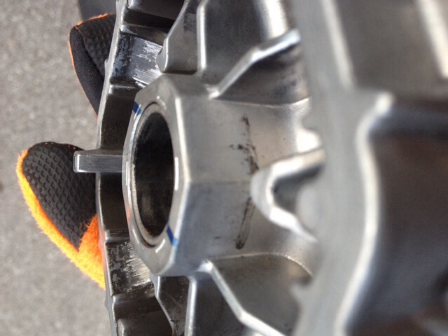

If the ramps were clean it would be easier to see this. You can see how the two ramps in focus do not reach the top of the pulley. They are shorter than those on the orange pulley. This limits how high the belt can ride and your gear ratio.
- image.jpg (82.09 KiB) Viewed 4921 times
Mgalutia88
- Posts: 783
- Year: 2013 PCX 150
Thus your top speed. This is why I'm saying upgrade your variator first. Your rpms are constant until the variator is completely extended then you start to raise rpms to redline. The longer the ramps the higher speed you are at before you reach lockup
