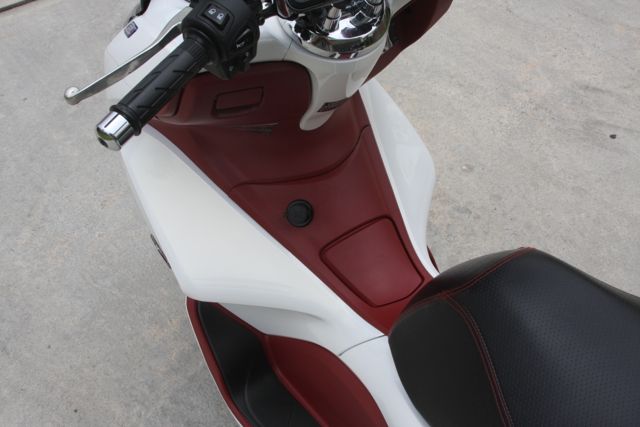

Re: How-To: Install a 12v Accessory Socket
Post by MagicSeaweed »
Just completed this, only needed to remove the fuel cover and battery case cover, was fairly easy back wiring it, then reaching up from under bike to secure the 12v outlet

Post by prenders88 »
The install I like the best is inside the glove compartment.
Maybe in the future a 12v socket and clock will come as standard.
